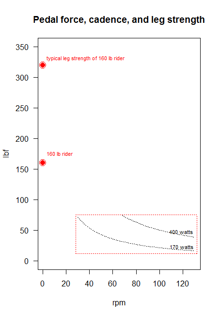

Fact: A cyclist with more strength can apply power in more gearing ranges than a cyclist with less strength, even if they have the exact same FTP (and for that matter, the same power profile.)
I’m using strength in the definition of being able to apply more force on the power half of the equation. Being able to put out X watts over Y time at 90RPM is not the same physical ability as being able to put out Xw over Y time at 60RPM. And in cycling, sometimes, that matters.
I’m not saying it doesn’t matter. I think you are talking past each other because you are using the same word but with different meanings.
Well, Cog has a PhD and I don’t. I defer in almost all circumstances, but I stand by what I wrote there.
Do the math. Even when having to accelerate from relatively low cadence, the force requirements are far below maximal. Indeed, even for a standing start effort on the track, differences in strength* only account for ~50% of the variation in the time required to cover the first 15 m.
*Strength is defined as the maximal force generating capacity of muscle, which therefore implies zero - or even negative, if you consider eccentric contractions - shortening velocity.

You can spin it (pun intended) however you wish, but as I indicated, it is not a matter of opinion, but of facts/math: very rarely is cadence low enough that one could rightfully claim that strength, per se, is a limiting factor. Spending time pedaling really slowly and/or in the gym is not how you reduce fatigability/enhance fatigue resistance during sustained efforts.

You claimed that strength matters at 60 rpm. It does not.
