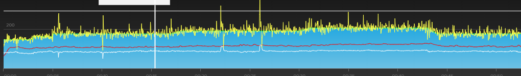

That has the looks of two apps being connected to the trainer, and they fight over the resistance.
Are you absolutely certain you had one and only one app connected?
The only other thing would be my Garmin, reporting out the values. Could this be the issue?
I did restart my tablet to ensure the tacx sw was not still running, but perhaps, somehow, it is did this in the background.
I’ll give it a try. @mcneese.chad do you have any examples of that by any chance?
I have had it on a few workouts over the years, when I had Zwift and TR paired to the trainer. Not sure I can find a specific one to show, because I usually catch it around 1-2 minutes in and realize the issue. I stop pedaling, kill or unpair the offending / unwanted app and return to regular function.
But the constant, and relatively repeated up/down pattern above sure looks like what I have experienced with dueling apps.

Quick update. Today’s workout albeit being a constant power recovery session worked really well. I uninstalled the Tacx app(s) on my tablet, connected the trainer using BT, powermeter with ANT+, and it worked nicely. The spikes below are either me tightening my shoes or some random form sprints.

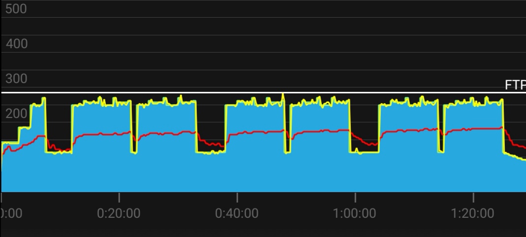

Here’s a picture of my ride from yesterday done using power match for reference
That is a 3 minute interval with a jump and subsequent drop between 144 watts and 407 watts

Sure. In fact, let me share two screenshots, same workout, different day. One day using PowerMatch and another day using just the trainer on Erg mode:
Take a look at the fluctuations and how the recovery intervals were not that easy when using PowerMatch.

To me the difference in the recovery valleys looks like a trainer issue, not a power match issue. Were you using the same gear for both rides? My assumption is that for one of them (which happened to be the power match ride) you were using a gear where your trainer was struggling with a power floor issue. That’s not to say it isn’t power match - but it really looks like a power floor problem more than a power match problem given the consistency of power readings when at higher power values
