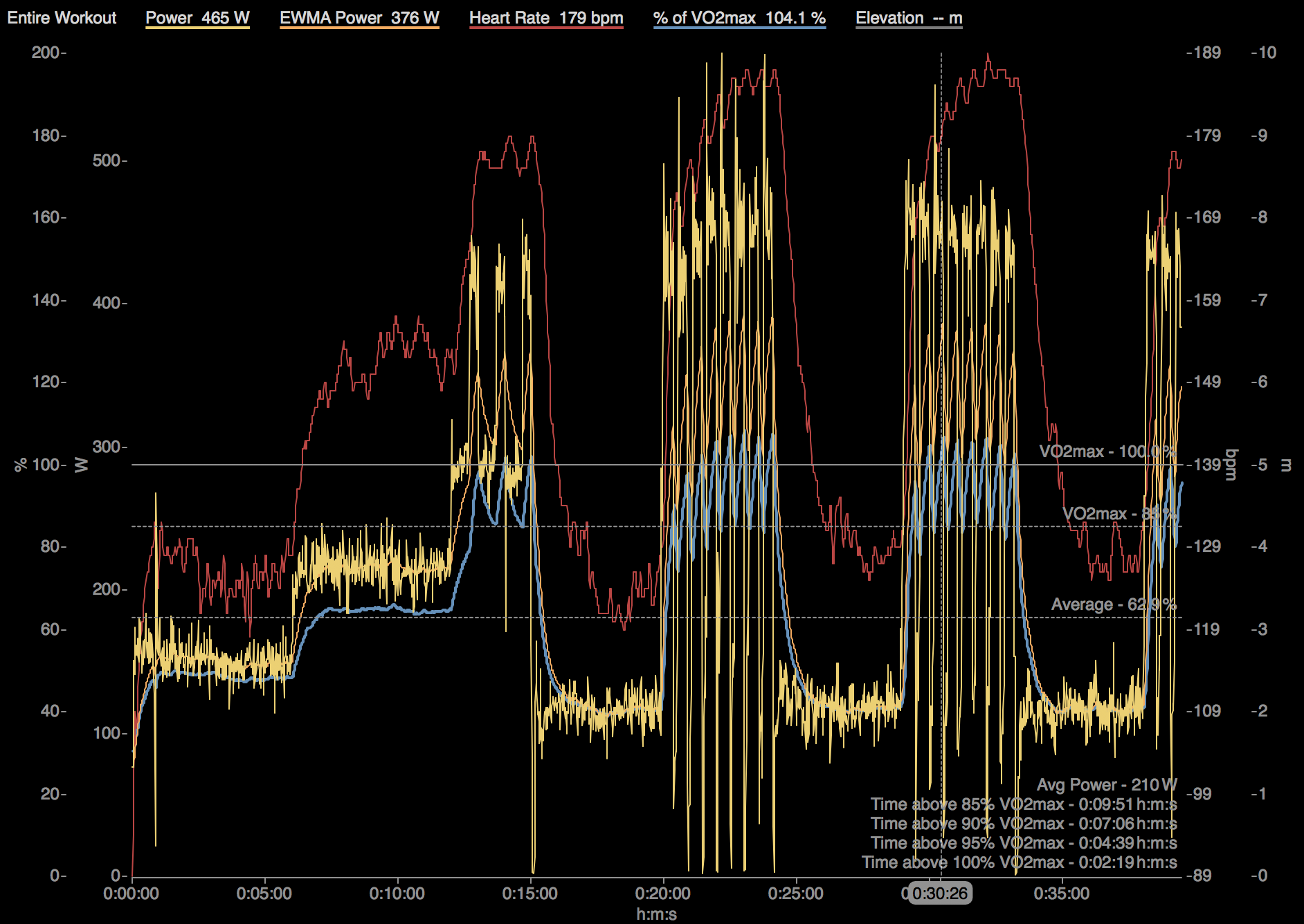

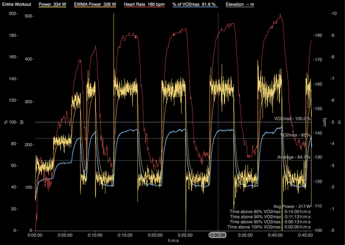

No, it doesn’t work well for 40/20s. I’m mostly using that as a hack for EWMA power (which you can look at in WKO4), which is a decent proxy for the physiological response. In general if you want to use short power intervals for maximizing time@VO2max, they have to be harder than what you would use in a longer interval.
Example of a few workouts:
30/30s @125% (5 sets of 5, Sleeping Beauty)
4 mins above 90% of VO2Max
20/10s @ 150% (Tabata-type protocol, could only do 2 sets)
7 minutes above 90% of VO2Max
Nunburnholme (6x4 @110%, bailed after 4 intervals)
11 minutes above 90% of VO2Max
How does WKO4 calculate “time above x% of vo2 max”? Is it HR based?
It’s all power based. They have a formula to calculate VO2Max power based on their power-duration model.
IMO I wouldn’t use HR as a VO2max proxy. It’s too variable and the lag is too significant depending on fatigue/hydration/etc.
You also don’t really need to get too complicated. For steady state intervals of 2, 3, 4, and 5 minutes, tracking time in the VO2Max power zone will give you a good sense of whether you are improving or not. If you are increasing the length of intervals and increasing TiZ, you are getting stronger.
