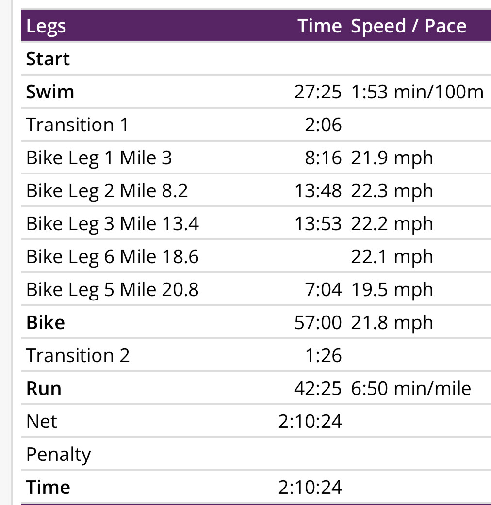

I did the Olympic distance Boston triathlon this weekend. It was a fun race and well organized. It was my first official Olympic distance race in 5 years (pre-structured training), and I set a new PR and finished at the upper end of my goal range. I made one big mistake, missing the bike exit on the first pass, but other than that I felt like I raced well and emptied the tank. I was hoping to be a bit higher in the AG rankings, but it was a faster race than 2021 for the 35-39.
Swim: swimming continues to get the short end of the stick in my training, but I felt good in the water. I think I could have shaved a minute or so based on my training speeds, and the fact that my middle 500 yd was ~25 sec slower than the front and back splits. I came out of the water 7/16 in the AG and had a good T1.
Takeaways: I felt like I could have done better about swimming in a draft. When you all talk about sticking to someone’s feet in the water, how close are we talking? Are you in the churn from their wake?
Bike: 4 laps on a ~5 mile course. During the bike, I kept telling myself
and it paid off. Was aiming for ~220 watts (0.85 IF) and was spot on. Avg was 220; NP was 225; avg speed 21.8 mph. The course has a few tight turns, so there are some accelerations getting back up to speed but I settled in to target power and stayed there. I did burn a match at the start of the last lap trying to follow a fast wheel, and it worked out (5% less power for ~ same speed). The big mistake of the day was that I rode past the bike exit on the first pass but did a quick U turn and managed to only lose 20-30 sec. Good T2 for me.
Takeaway: I have started saving for a tri/ TT bike. I may not ultimately pull trigger, unless I see FTP increases. I feel like I need to be more aero if I want to get into front pack, especially on a flat course like this one.
Run: I started out around 7 min miles but faded a bit and ran miles 3, 4, 5, at 7:15, 7:30 and 7:25. I had good final push getting back into 7:00 pace. My “official” speed was 6:50, but I think I actually was closer to 7:10/ mile.
Takeaways: I need to be in 6:30-40 pace if I want to be in front-ish group. 6:30 is my current 5k pace so I have some work to do here…
Nutrition: sleeve of bloks before the race (60g), 60g of drink mix on bike, one gel (30g) on run. Small sips of water at aids and one swig of Gatorade. I had an extra gel in the tri shorts and probably could have taken it during second lap of the run, but I don’t think it would have made much of a difference.
Summary: my final time was 2:10:24 6/16 in AG. My time would have put me in top 3 of 35-39 last year, but the top 4 were all right around 2 hours this year (1:58-2:02). I think I could have shaved a bit with better swim and no bike exit error, but we are talking 1-2 min max, not enough to be on the podium.
At end of day though, I enjoyed the race, and thanks to this community for advice after my June sprint. Mantra of “ride your own race” kept me from burning matches on bike and paying for it on the run.
