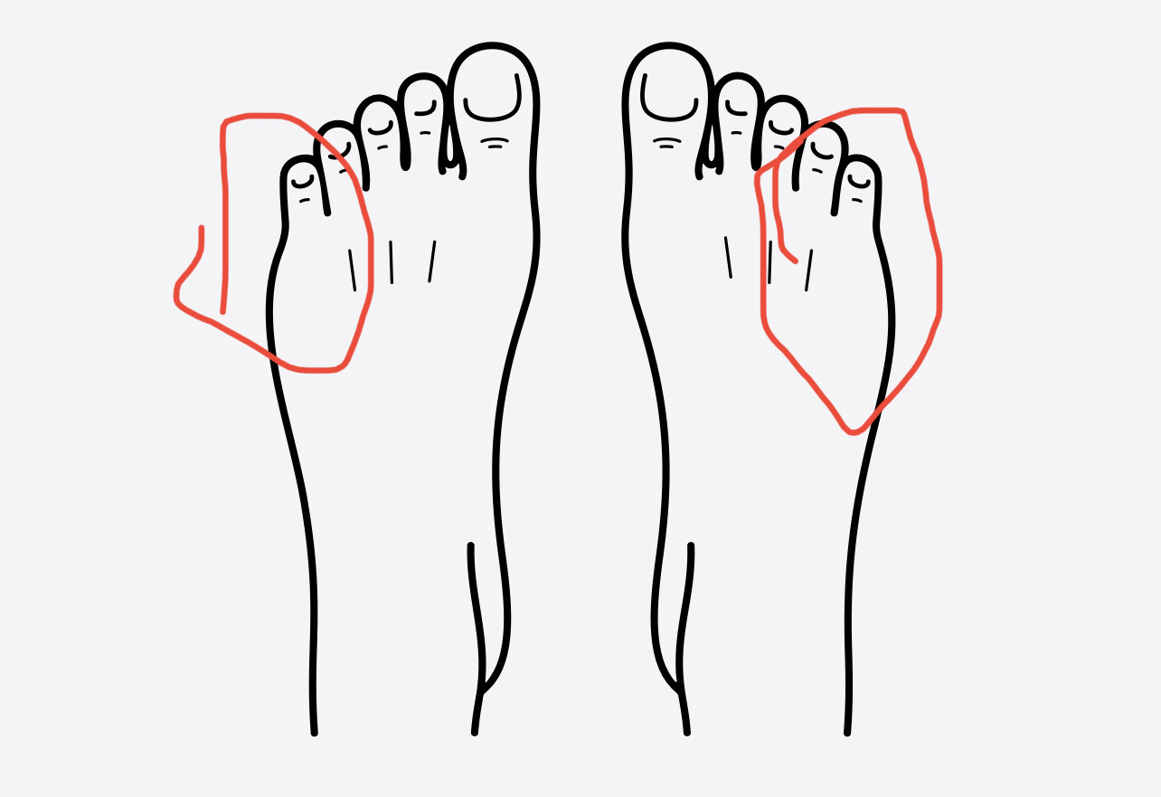

I have speedplay pedals and I have noticed that I have been feeling pain in the circled areas on longer rides:
My gut instinct is to move the cleats on my shoes inward? Are there soles I should consider getting?
I would think you would have to move them further outside, but I’m not an expert so…
If your feet are supinating (if you sit on a chair and leave them dangling and they look like this from the front / \ ) then you might have pain there because there’s quite some pressure but they’re not supported enough since the cleats are too far inwards. If that makes any sense?
I’d have a read of this first.
The lateral cleat position helps knee stability. You’re looking to get the tibial tuberosity (the boney bit that sticks out below your knee cap) directly over your second toe at the top of the pedal stroke.
If you’ve not had a bike fit maybe both need optimising.
I saw someone mention best bike advice website for a fitting. I went and tried it out and it’s pretty cool. I had gotten a fit from a local fitter and it wasn’t far from where he had me at(I was skeptical of his fit because my saddle is all the way forward-seems extreme. Anyway, I’m curious how they incorporate cleat placement. I’ve recently put my cleats all the way back because of some calve stiffness and issues with my feet. However just having measurements of where stuff is supposed to be doesn’t seem to incorporate that. Am I missing something?
As a side note I think this is something myvelofit Has on them. Make adjustments and record yourself to see the immediate impact
  • If you are talking about the post-fit bike setup documentation, that varies with the system in use and fitter as well. Some systems include the cleat setup in the process and final documentation whiles others don’t.
  • I include the cleat setup in my own document that I have refined after using several different sheets and systems over the years.
You are suggesting a functional change to Stance Width. It may work for you, but it’s not the first place I would look to adjust for what you describe.
Inner shoe issues with the foot are more commonly addressed with insoles and wedging (inside or outside of the shoe). The specific solution will vary, but using Varus wedges (thicker at your big toe, thinner at your little toe) would be the first thing I would try.
