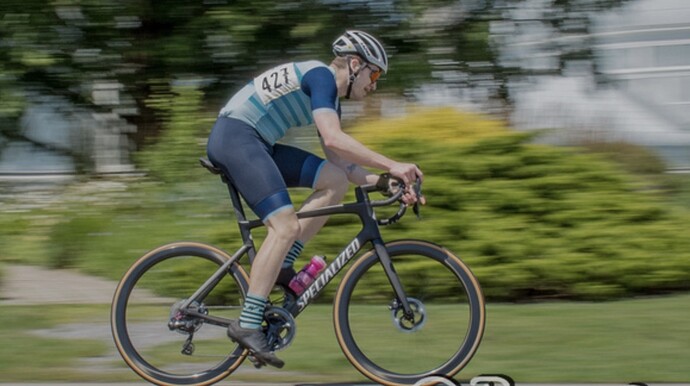

Ok, I know you can’t always tell from a single picture, but do you think I could benefit from going to a longer stem? This was from a race where I was putting in a big effort to establish a break. I look scrunched up and thinking I could extend out and get more aero.
If pressure on hands and neck pain allows for it, I’d say it could be worth a try. But some other approach would be moving saddle back.
You could absolutely use more reach…you have a lot of low-hanging aero gains to grab.

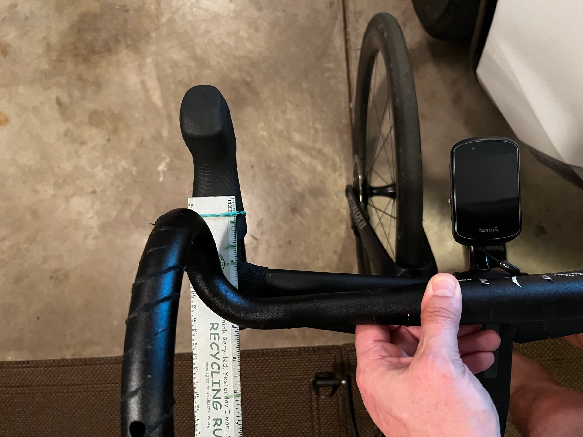

I’m wanting to swap bars from 42 width to 40. I have 40s on my trainer bike and have gotten used to them and took my road bike out and the bars felt wide. I’m also looking to get a one piece bar and stem so was thinking about getting a longer stem along with the bar width change.
How much will steering be affected by going from 110 to 120, along with going from 42 to 40 width? Just something to get used to?
Edit: Also, I did a quick calculation and going from 42 to 40cm bars would shorten the reach by 3mm. So a 10mm longer stem would only be 7mm longer than my current setup.
