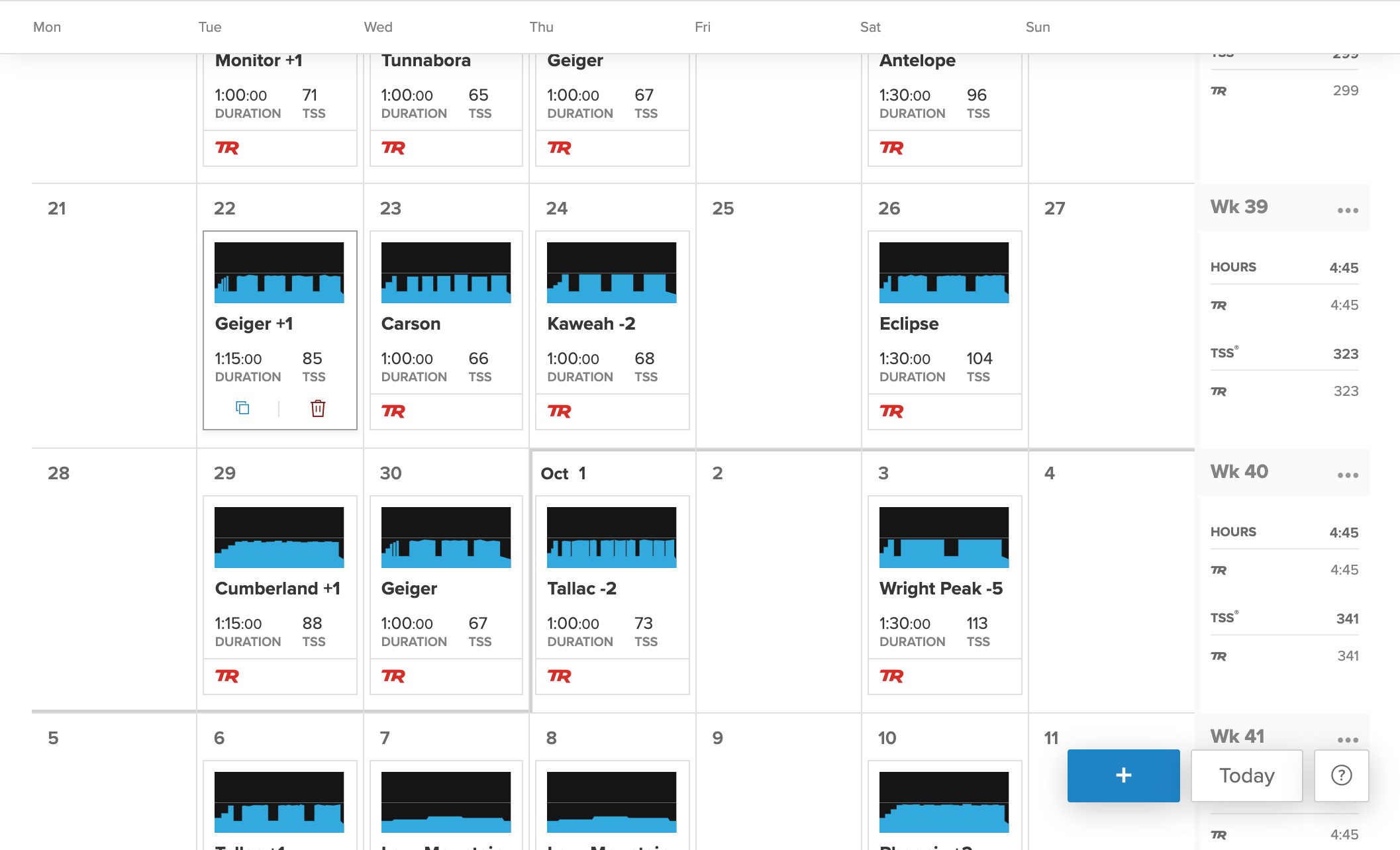

Ah, I gotcha! You all are so smart. I’m glad I got the courage to ask how my plan looked!
What do you think if I progress with the longer sweet spot intervals as @anthonylane has laid out and to jazz it up a bit add some shorter intervals at threshold? Orrrrrr could I squeeze this progression in to a smaller amount of time?!
If you will introduce threshold workouts you can stack the workouts, so one day threshold and next day SS work. But be careful with number of hard days. Usually more than 3 is considered hard to mantain in longer term (with this long SST I would also think about it as hard days).
Squizing the progression in a shorter time frame will be super intensive but potentially super rewarding. But you can also crash and burn :slight_smile: there is a lot of factors contributing to this but this is recommended for experienced cyclist. Here is thr article that should help you with this:

I think I will stretch out the progression to 16-18 weeks, and use the 90% workouts. I’ll do two hard workouts a week, sometimes two sweet spot, sometimes one sweet spot and something else. Some lower tempo work will be a moderate workout if I am feeling good.
This would be the ideal structure:
Monday - Off
Tuesday - Sweet spot workout #1
Wednesday - Tempo (not sure if 85% will be too high, maybe 80%?)
Thursday - Zone 2
Friday - Zone 2 or off
Saturday - Sweet spot workout #2 w/ added zone 2
Sunday - Zone 2
Maybe swap Wednesday and Thursday around if I need an easy day between the sweet spot and tempo.
I’ll probably throw in a VO2 or some suprathreshold intervals every other week or so.
