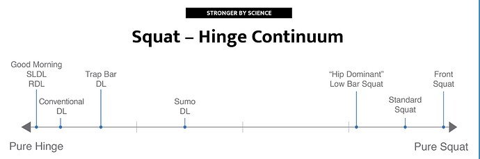

Hex bar dl’s are a lot closer to a squat than a dl. My non professional advice is I would try them for sure for what you’re thinking of doing.
They look painful, but zercher squats might be worth looking into.
Hex bar squats are closer 1/4 or 1/2 squats or what I did because I have angry rotator cuffs that don’t like back squats, I got safety squat bar.

As @ZeroGravity said, I think a safety squat bar is the closest alternative to a regular back squat for people with limited shoulder mobility. Not all gyms have them though
Not that close TBH
Try low handle on the hex bar and it is pretty much exactly a deadlift except your hand width is fixed. I think it’s a great piece to a a different lift for variety
Interesting, maybe Im wrong, it should have read Hinge-squat continuum, as the hexbar dead lift is closer to the deadlift rather than a squat?
