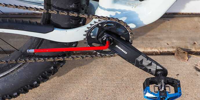

Putting this here because I didn’t want to start a new thread.
James Huang recently wrote about changing SRAM DUB crank bolts to a steel version rather than aluminum to make removal easier.
