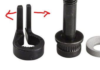

Essentially, the are anti-turn devices. No big deal to rotate one in place, assuming the screw is still properly torqued.
Ah, I see and understand the principle. Thanks! But do you mean that it’s okay for me to do one full turn on around to get it in the same position as it was or should I just leave it as it is? I think in its original place it was flush with the body of the housing and therefore I never noticed it. Now it’s sticking out at an angle if you know what I mean. Or is there any way of pushing it back by those few notches without putting adverse force on it (or breaking the thing)?
Cheers!
  • Assuming the actual mount screw is installed at the proper torque, you should be able to rotate the plastic cap with no problems or negative impact.
  • Something tells me it is installed “wrong” on your bike. Can you take and post a picture?
  • To reposition the easy way, imagine it as a “clamp” and open the legs of the cap to make it turn easier. You can wedge it open with your fingers or a flat blade screw driver and position as desired, then release.

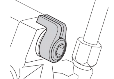

Ah, that all makes sense now, seeing that diagram there coupled with your explanation of repositioning! Great stuff!

  • To clarify, sometimes I see people install the plastic cap with the points sticking out, away from the bolt.
  • It should point along the direction the screw is installed, like this pic below:
If that looks like yours, you are all set. Sorry for making you worry. It’s just a small detail that some mechanics don’t even realize the actual purpose or install on some bikes.
