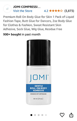

After they fell down i glued them on, but didnt trust it to work for a long gravel race.
This stuff works great and less messy than any spray. Have used for my gravel and MTB races.
