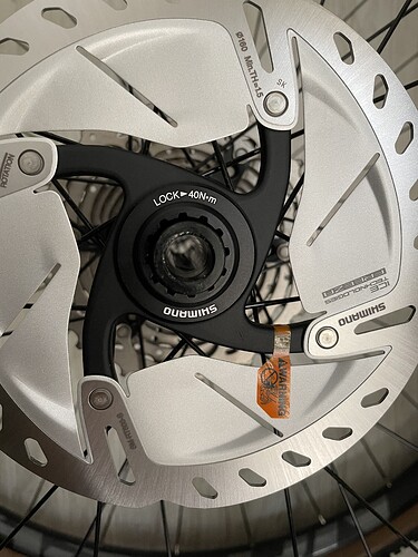

Can you pull off the hub endcap with pliers? Then your tool would fit. Some end caps have a flange that means they’re held in place by the lock ring, but I can’t tell if that’s the case here.
It looks like it to me. I can see teeth marks in both those pics.
The Shimano rotors I’ve bought all came with lock rings like those on your bikes. I had to purchase a different lockring for the front wheel to accommodate the larger axle.

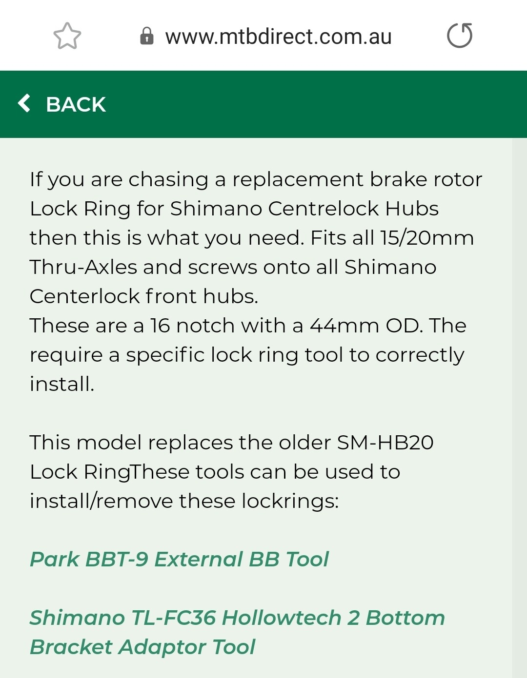

Both taken from the MTB Direct website. My favourite online supplier in Aus by far.

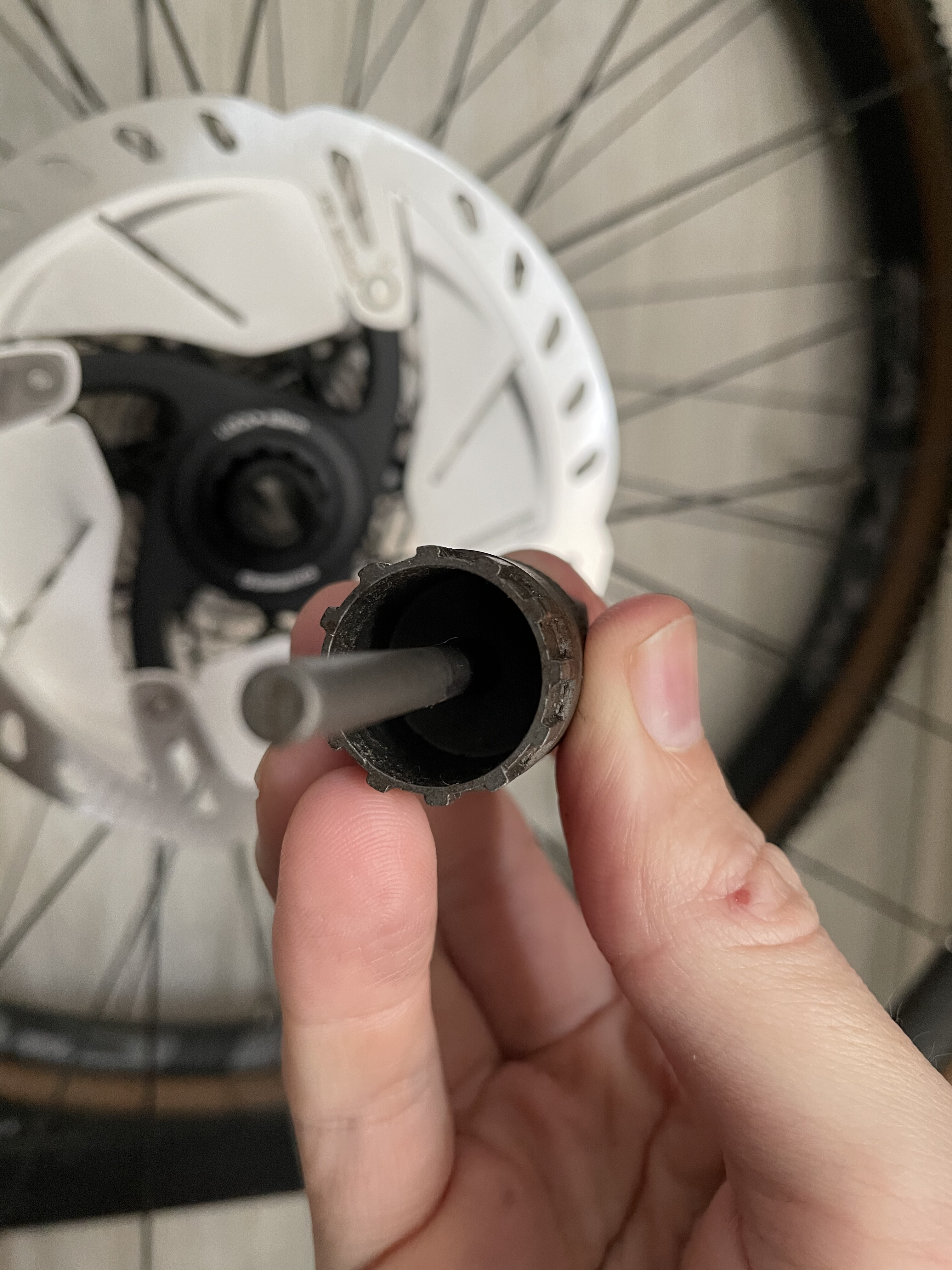

I think they just used a thin walled cassette lock ring tool. The splines in the center-lock lock rings are the same as those on cassette tools. Some older design cassette tools have a thick wall because they just had to clear a small diameter axle. Since newer bikes have thicker axles, newer design tools have a thin wall that can fit between the axle and ring. The wheel builders likely used that.
Here’s my cassette lock ring tool. See how thin the wall is between the splines? That’s what you want.

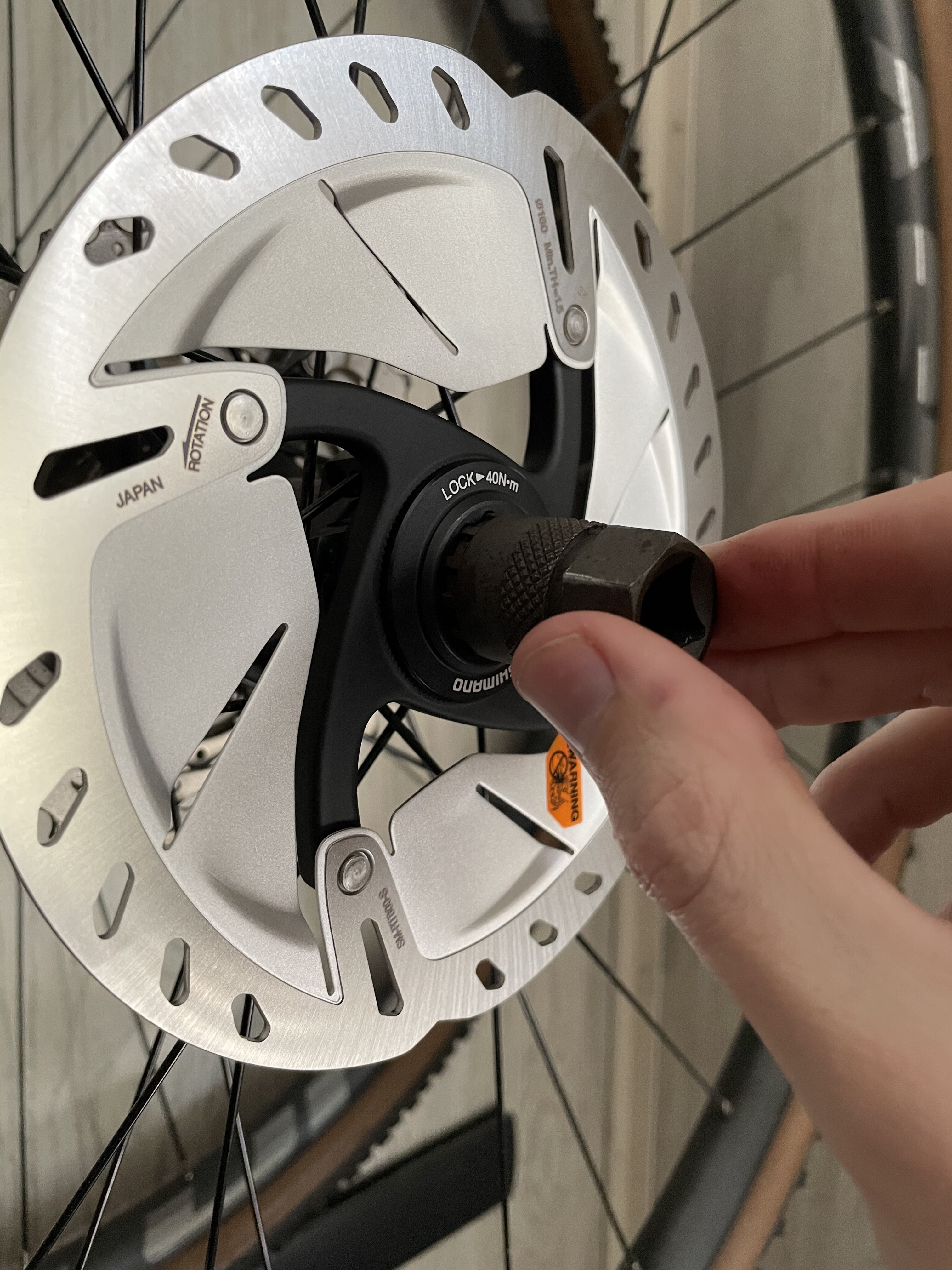

That’s interesting that yours fits. What brand hubs are they?
I’m running DTSwiss 240s hubs on my carbon hoops and there’s no way that tool would fit. (I had to check to make sure I wasn’t going mad).
The DT 240s (on my bike) have approximately 0.4mm clearance with the standard Shimano lock ring.

That’s interesting. It does look too small of a gap. How did you get the lock ring on in that first picture? If you used pliers, you did an admiral job not damaging it.
My picture is from a set of Easton wheels. No problems with my DT 350s or Fulcrums either.
Clearly your second pic is a different design that uses the BB tool and would avoid any clearance issue.

That first pic was simply hand tightened so I could check the gap with a feeler gauge. I’d end up marring the metal any other way.

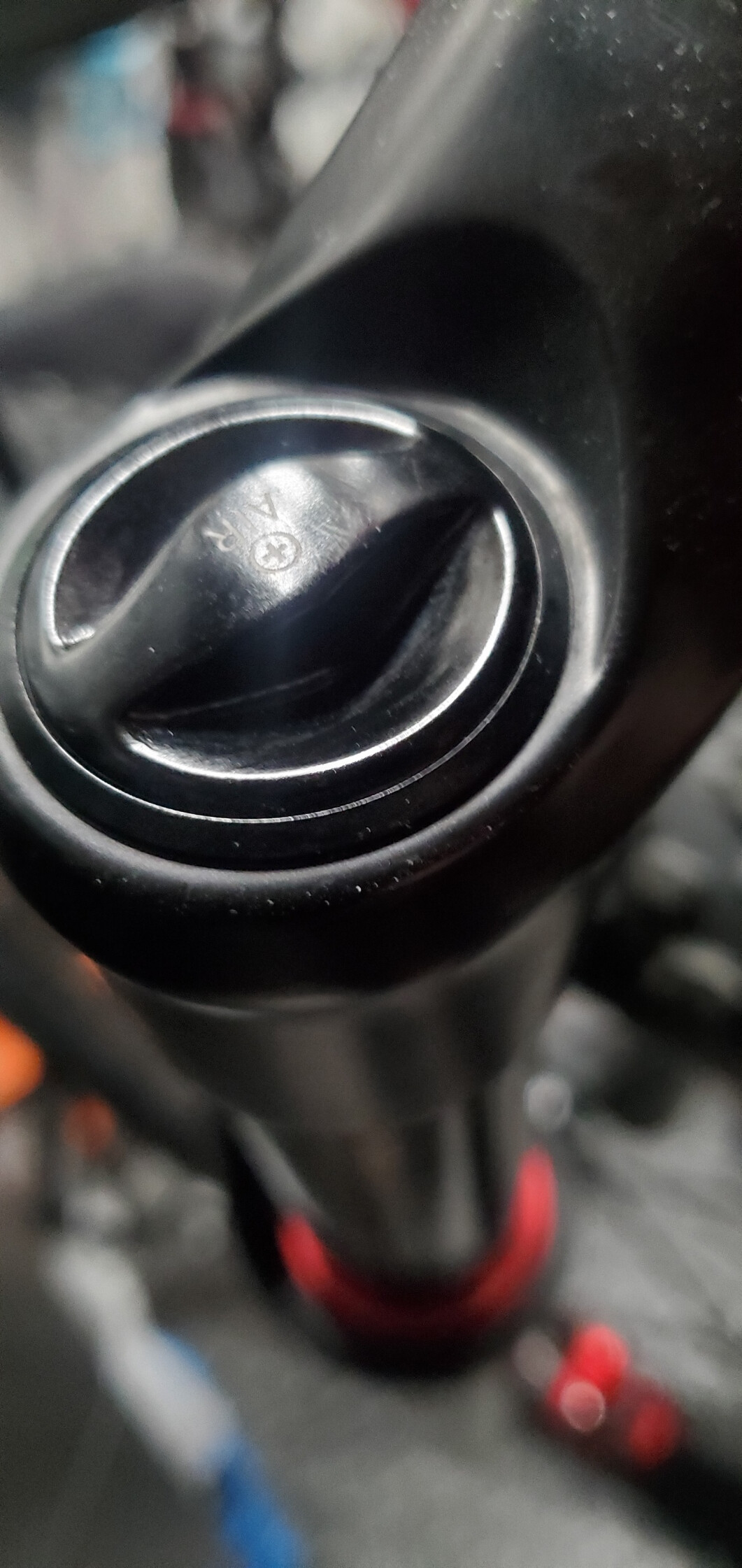

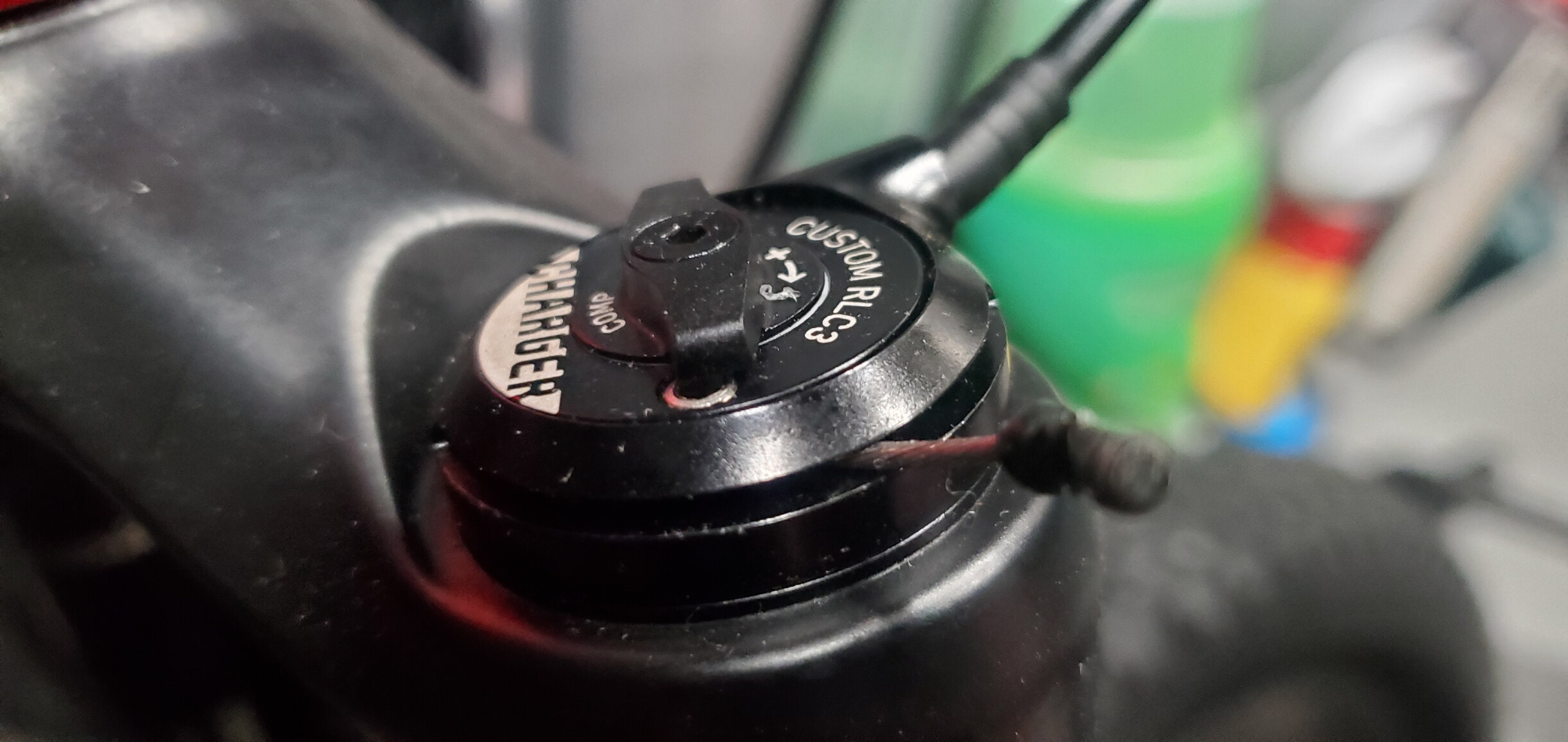

If so, then presumably there is a very low-profile hex nut I’ll be needing to wrench on, on the fork somewhere, right? (I’m not seeing it on the external of my fork.) Where on the fork is it? Under these??
Second… why aren’t all sockets manufactured chamferless?? Seems like it would be an easier manufacturing process. Also seems like it would increase contact surface area whenever the user is wrenching on it. Maybe the chamfer (if I’m understanding what it even is) is just there for ease of inserting whatever you’re wrenching on, into the socket??

The same reason the nuts have chamfers. If you have space you design things to work easily in real world applications. If you don’t have the space you design things to tight tolerances.
Forks are quite compact and they try to shave weight wherever possible.
Your pic looks like there is no hex nut on top of the air chamber. All of my forks have a very thin hex nut. Hence the chamferless socket.
I’ve read that some use a different tool. Check the fork manufacturers instructions for your model.
While you’re there you can see if your forks allow you to play around with “tokens”. There a small bit of plastic that reduces the air volume in the chamber.
