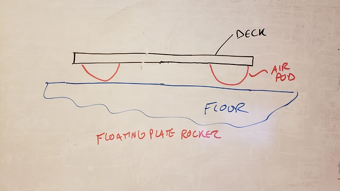

I should add, you can also consider a hybrid of the Floating and T-Plate rockers. You can include a row of pods down the middle (instead of the rigid vertical board).
This allows some more control against bouncing, by providing some center support. You can set the middle pods to a higher pressure too…
So, there are plenty of ways to play with it and see what you like best.
