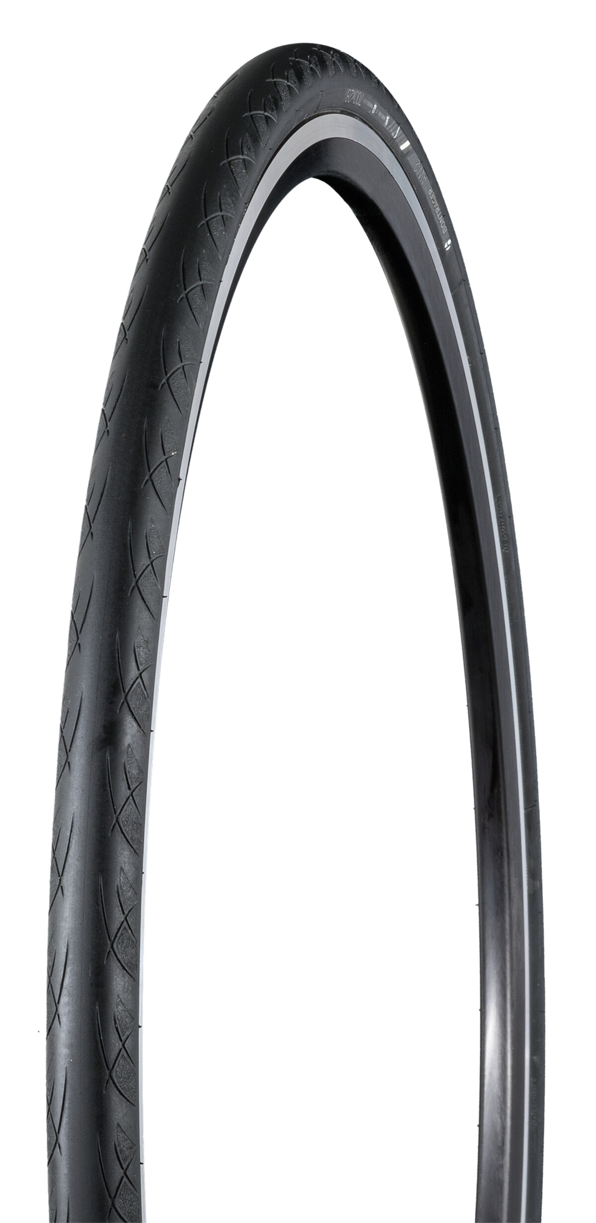

  1. In my experience, no difference, use sealant.
  2. Hutchinson road tubeless tires have a miserable track record with me, all blister or the tread delaminates.
  3. For training, Bontrager AW2 “hard case”. “Hard case” is a bit of a misnomer, the tire rides similar in feel to my Corsas, no percievable difference in grip but haven’t low-side crashed/test the limits, ran the 28mm tire. Was cooking on a few descents in Albuquerque on them, felt good and did not miss the Corsas on the race wheels. I also like Schwalbe One and I’m itching to try the tubeless Crosa 2.0 and maybe Rubino.
