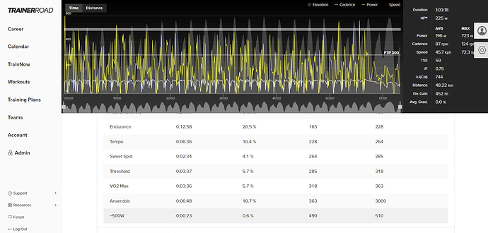

I think what you’re describing might be our option to add a “custom zone” to your Power Zones chart. Here’s what it should look like:
Then, you’ll get a menu that will allow you to specify the power for your custom zone:
Once you’ve listed the power you want to check out, click on “Add Zone,” and it should appear on your chart!
Hope that helps – let me know if you have any additional questions!

The “custom power zone”, while useful doesn’t allow me the same comparison.
