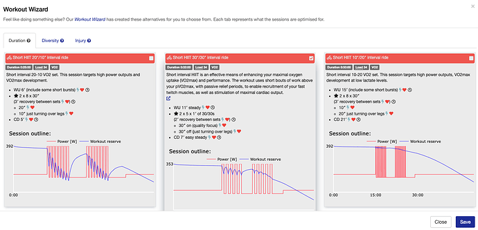

Here are three nice examples from my Athletica profile using our Workout Wizard feature.
Here we have options for 20/10, 30/30, or 10/20. They all have a similar training load (i.e., TSS) but different durations and different physiological effects. The blue line is a proprietary algorithm called Workout Reserve. Initially think of it like your battery level. You can see that the bigger drain on your WR naturally happens in the 20/10 and 30/30 sessions - larger draws on your battery. 10/20 not so much.
While I only know you from your username (RecoveryRide) and what you have written here…
… my guess is that you might be either a hybrid or twitchy phenotype (step 1). That is, you probably don’t recover well from hard training. As per our recommendations (step 3 and 4), you’ll likely do better with short over long intervals and you’ll need to be cautious with too many long intervals or threshold type work, which will heighten your sympathetic stress and eventually bin you. I can go further into mechanisms (myoglobin, etc) if it interests, but that’s likely more than enough to start.

I’ve never seen 10"/20" intervals before. Can you explain more the rationale behind this type of intervals, and if there is some published research behind this? Are they targeting a specific part of the VO2 components?
Sure @ChrisDe. You would use a 10/20 format (Type 1 HIIT) in the context where you wanted to target the aerobic oxidative system but keep anaerobic glycolytic and neuromuscular load lowish. This is published in our book (including over a thousand references) Science and Application of High-Intensity Interval Training; Solutions to the Programming Puzzle. This type of format is used often in the team sport context where players need to keep the aerobic stimulus topped up but recover between matches. A blog version of our HIIT Types is here for reference. But no issues using these same principles in endurance cycling and running contexts.
