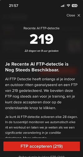

I read that TR ftp detection is great. Im struggling with this for a long time and now I have some proof to show.
This weekend raced Dutch Championships 6 hours race (MTB) finished 3rd and raced with 206 NP. Last 3 hours stept of the gas a bit as I doubled #4 and # 1-2 were a size too large for me :grin:
But…. TR detected my FTP at 219 (Im 60+ yrs) but I raced for 6h at 207 NP and
1 hr - 230 / 2hr 225 / 3 hr 219 (all NP)
So is TR ftp detection correct? Dont think… hope to find the answer here..
Thx and KR Jan

Absolutely true…. Fully understand… my point is that T0 gives me an AI ftp of 219 en I can ride 219 avg in a 6hr race.. this is in my opinion not correct…

Thx ohjelm for your help… to answer. I think started using a power meter in the early 2000 (SRM) and never not used a power meter since. Im using TR now for 3-4 yrs I think and was of for 3 months beginning this year, but did not stop training (with pm). When coming back to TR, it analysed all my pm data and gave me a 255 ftp. which I think is good. Then, I dropped to 219 and did not get of that number. Now I raced a 6 hr race and did not raced at power as I believe 219 is not correct, so rode as good as I could, which resulted in the shown numbers, which confirmed my conclusion that 219 is not correct. I don’t blame TR, I dont blame the AI model, I just want to know what did I do wrong, or where did this go wrong as TR is very fond of the accuracy of their AI model.. hope this info helps…. KR.

If you want to know your FTP, go out and test…. Simple is that….BUT…. TR advertises that the AI model is so good that ftp test are not needed anymore and I find (already for some time) that for me the number is wrong and I want to know why.
To answer your question… when I ride and use 219 as ftp, training as waaaay too easy. My thought was that after this race (I did many more in the past with high numbers then 219) it would suggest a higher ftp, but it did not.
So for me it is not clear why I ride these numbers and why is TR giving me this ftp.
Note: I do my training 240-250 ftp and then I still stay on the top side of the scale…
