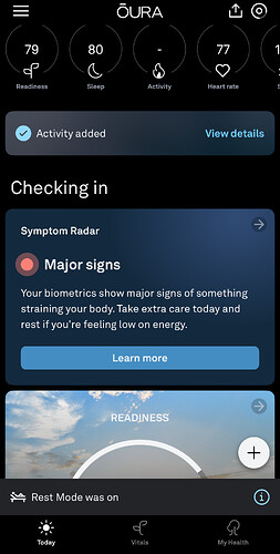

Ok, so today, after a red and 2 yellow days TR gave me green light after I took a rest day yesterday.
Today I was prescribed South Twin +2 (VO2Max 5.7)
But Oura flagged a red day.
Some objective metrics are above baseline, so definitely not a good idea to go hit a hard effort. What would you do?
