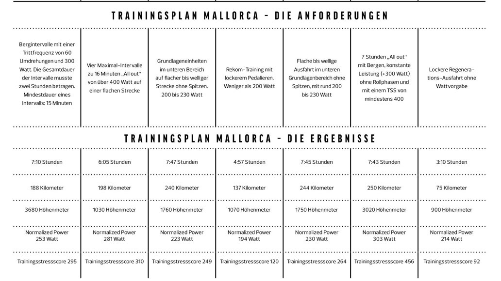

In a previous post I’ve showed Christoph Strasser’s (RAAM record winner) 2019 spring training camp week in Cyprus. Here is 2018 on Mallorca (late spring; this followed a first spring block on Cyprus):
300W is low tempo for him, seems a crucial effort level for him. RAAM race pace?
400W is slightly above threshold
  1. 7h with at least 2h @300W & 60rpm (minimum interval duration 15’)
  2. 6h: 4x16’ all-out (~ 400W)
  3. 7:45h easy endurance (200-230W)
  4. 5h active recovery (!!!) (<200W)
  5. 7:45h easy endurance (200-230W)
  6. 7:45h with “7h all-out” (all climbs @ >=300W; reduce coasting to a minimum) → achieved a NP of 303W !
  7. 3h active recovery

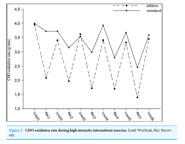

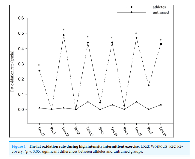

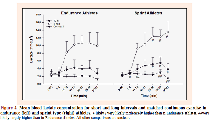

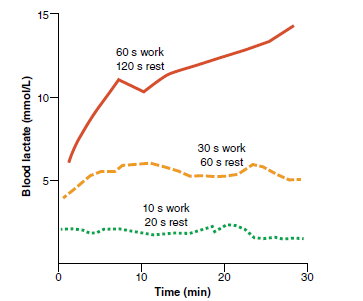

Perhaps if you’re utterly untrained. Any higher intensity bout will produce lactate. A key characteristic of endurance training status is the ability to clear lactate. Clearance by oxidation. Lactate is inversely correlated with fatox.
These are “moderately trained” subjects following a 5min bout:
grafik
a long interval at high intensity produces a lot of lactate
grafik
with the following effect:
fatox is zero in the rest period because lactate is used as substrate. However, these were 4min bouts. Not 15 seconds.

energy demand. but at a certain intensity you’re body can’t transport enough fat into the muscle. This is a key limiting step in the utilisation of fat. One of the adaptions of endurance training is a higher permeability for fats. Furthermore, a higher intra-muscular fat content which is not affected by permeability restrictions. This is why well-trained subjects meet >30% of the energy demand for 6x4min @82% VO2max from fat, whereas untrained subjects used 100% carbs.
