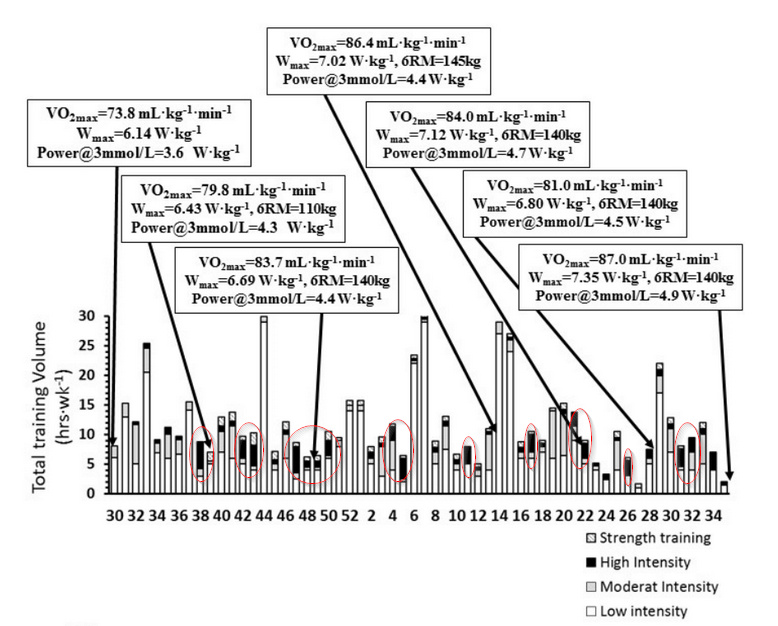

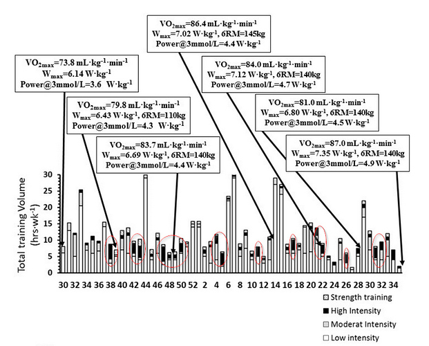

He ended with a Vo2 of 87?
That’s higher than GT winners??
I’m experimenting with a block protocol that is similar. It’s actually not as bad as you would think in terms of fatigue (so far) provided you have good intensity discipline.
I doubt I’ll be adding 10 points to my VO2max in a year but hey, it’s worth a shot!
The load with HIT seems quite managable. Most of the times only 1 or 2 weeks with more HIT.
This seems very inline with other training & testing protocols which show maximum VO2 increase ~2 weeks after completing a HIT/VHIT (Very HIT) block.
from the discussion in the fulltext:
It is interesting to see that the first adaptations to systematic BP was rather large during the
first 9 training weeks despite focusing on LIT and MIT blocks, which is suggested to be a less
potent training stimulus than HIT.12 The adaptations during the next 9 weeks are likely
influenced by the incorporation of HIT blocks.3 There is a quite large development in VO2max
during the first 18 weeks of the intervention before the cyclist seems to reach plateau.
Do we know what the definition of LIT/MIT/HIT was wrt FTP?
sorry, sorta answered my own question:
The 8 first weeks therefore focused on blocks with LIT (intensity zone 1: 60-82% of peak heart rate; HRpeak) and MIT (intensity zone 2: 83- 87% of HRpeak) with approximately 1 weekly HIT (intensity zone 3: 88-100% of HRpeak).
