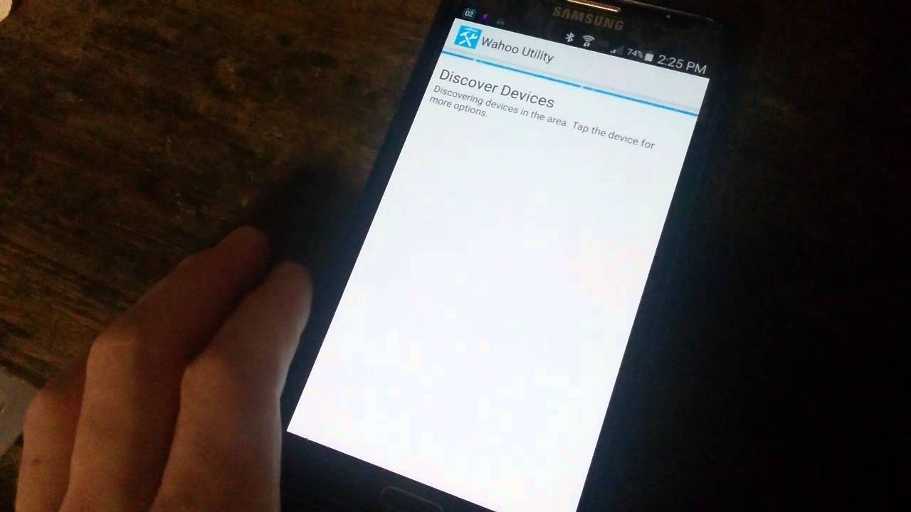

Here’s a video as to how to open the developer options using Android:
The current production firmware seems to be the most recent, so I don’t think there’s any need to switch to beta firmware, but I believe this is how you get to the “switch to external powermeter” option which requires a password.
