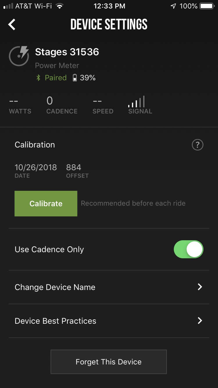

I have a Stage R powermeter and a KICKR '17. I let TrainerRoad connect to both, I turn off power match and in the Stages I have the ‘use cadence only’ box ticked. This means TrainerRoad will count cadence from my Stages but no power data. All power data comes from the KICKR.

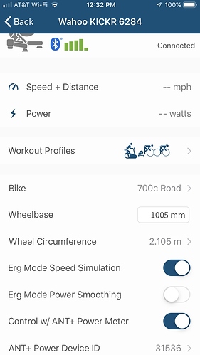

Regardless, I decided to remove TR from playing monkey in the middle and let Kickr use Stages for power measurement. In case someone wants to do the same, here is how:

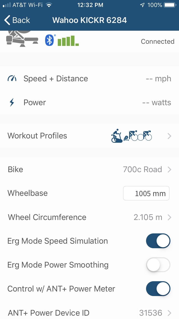

  1. One-time configure of Kickr to use Stages for power data.
In the Wahoo Fitness app on your mobile phone, Toggle “Control w/ ANT+ Power Meter” to on, and then enter ANT+ Power Device ID (my Stages ANT+ ID is 31536).
  1. Verify you completed step 1 correctly:
In Wahoo Fitness app, start a workout with your Kickr selected as power source. Click the symbol in upper left of screenshot above, and verify you see the “Control w/ ANT+” icon - its the “lightning bolt inside two circulating arrows.” In this screenshot, the “Control w/ ANT+” icon is to the left of the hammer/wrench icon.

  2. (Optional) Configure TrainerRoad app to use Stages PM as Cadence only.

This is possible on an Android app as well? Also, if the Kickr is using your Stages to control the ERG mode, how does TR control the ERG mode? What does it send the instruction of target power to? I presume TR tells the Kickr, and the Kickr generates the power but uses the Stages to decide? Can’t quite wrap my head around that.
Also you did a calibration at 38C? Where do you live?
The Kickr receives a power target from TR app. It controls resistance by using the Stages PM for current power.

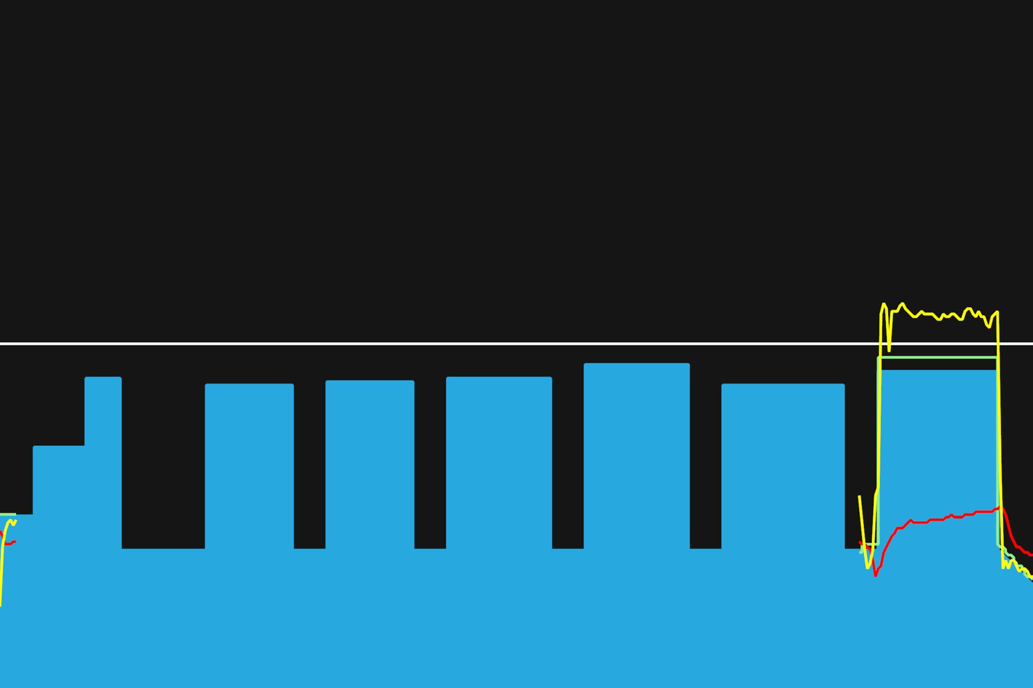

I get weird results when I use PowerMatch. My laptop dies during Carson today so I did the last interval using Erg mode on my phone. It is still on PowerMatch on my phone for some reason.
I have no idea what that means! Did I do the interval as planned, or too hard?
Don´t you feel the difference between over and under FTP efforts?
The yellow line is your actual power, as measured by TrainerRoad, and the green line is called “actual” power, which is almost always equal to the top of the blue boxes. So, you over achieved on the power front.
but I was in erg mode, so I shouldn’t be able to over or under achieve the target wattage should I? That’s the problem!
As I see it, the yellow should be on the green line, but it isn’t. I think it has something to do with a bad powermatch.
