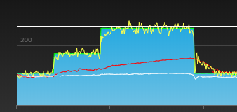

I’ve struggled with PowerMatch for years with large changes in wattage. Going from low wattage to Vo2Max for example will see me overshoot the interval for 30 secs and then when it’s over go way under for about a minute. I’m running a Kickr18 with Stages Gen II.
I was so excited to see ePM get released today and crossed my fingers that this would correct things. Here’s my ride of Tunemah from last year:
Screen Shot 2020-08-01 at 9.21.30 PM
and from just this evening:
Screen Shot 2020-08-01 at 9.21.14 PM
You can see that the Kickr is responding to the prescribed wattage so much better. Huge thanks to the TR for working on improving this. :+1:
