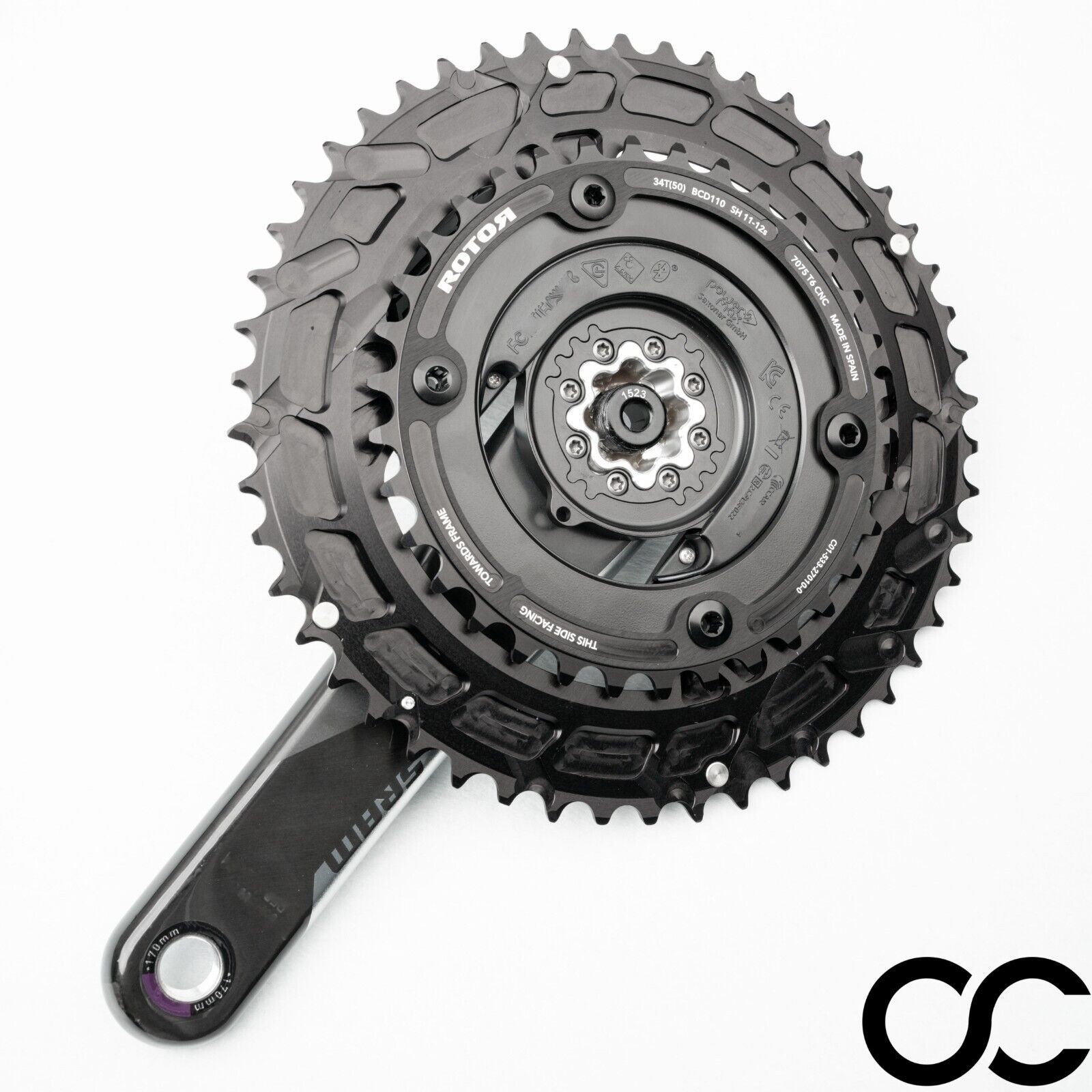

A new P2M spider?
Seems to use an interesting design where the spider is “universal”, with a separate mounting plate that allows for connection to various types of direct mount cranks. Could see it working with rotor/easton/sram etc mounting standards, while allowing one to keep the same chainrings.
Probably not huge mass appeal, but would be useful for me when using shimano 2x chainrings on bikes where I have rotor and sram cranks. Also for MTB where i’d be able to use the same spider on my sram 3-bolt and eewings cranks (need to flip the orientation of the spider in order to clear the battery hump.

This looks like a strong play for them to reduce SKU count internally. If you’ve only got to make a single road, gravel, and MTB model, their stocking costs go way down while their responsiveness to the market goes up. The machining on that spider interface looks problematic.

What is problematic in your opinion about the spider interface?
It has a tapered interface to the PM, no bolts. It needs to interface multiple crankarm types on the backside of that. in other words, it needs pinch that same universal spider to multiple thicknesses of cranks. That cloverleaf interface also has to be to a tight tolerance all around the finger for size and taper and relative to the other fingers on both sides…and not wear a lot. I could be very wrong as I don’t see all the angles here.

I’m not saying it doesn’t work, I’m just saying it looks difficult. Now I don’t see a pic of the unmounted spider or have any detail from the engineers, but if it was as easy as putting an cheap insert into a universal spider, they would have just done that years ago.
