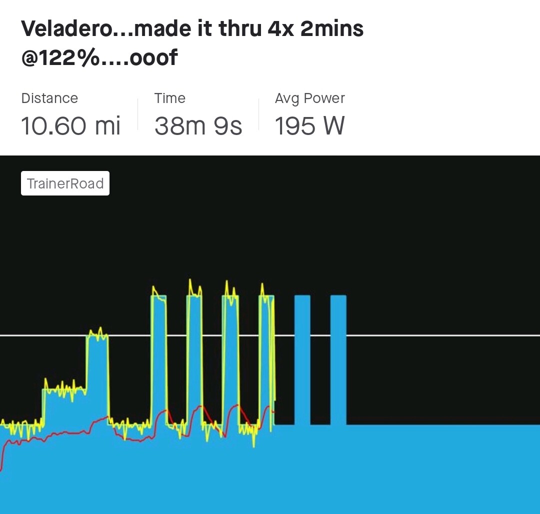

I’m giving the polarized plans a shot and am currently in my first week. I had a 6.2 VO2 max today…I crashed and burned after 4 intervals (4x 2 mins @122% :flushed:). Realistically I probably should have done a 5.0 or so based on recent rides.
Since there are only 2 intensity days in the medium volume base plan, should I do another VO2 workout that I know I can complete, or would this still β€œcount” as my V02 intensity workout for the week?
Start with not doing vo2 max by percentage of FTP. Do it by feel and as hard as you can but with duration in mind. If you have burned with 2 min @122%, 120% is not a good percentage for you probably. You can also try to take 90% of your power for a given duration and go from there and adjust during the intervals. After finishing, take the avg power for all intervals and start from this during next 2min workout.
If you are following the medium volume polarized base plan (6 week plan) and in the first week, why are you doing Veladero? I just did the Ramp Test to start the 6 week base polarized. The plan does not go above level 6 until week 4.
I did a 20 minute test less than 2 weeks ago and am confident with the number.
I wonder why your VO2max progression level is so high? Seems too high if you were unable to complete the workout.
That’s what I thought too. I’d done a 5.0 VO2 max recently and was comfortable with the FTP number from a 20 min test less than 2 weeks ago. It served me a 6.2 VO2 max which proved to be too big of a jump. I’m going to pay closer attention to the levels on the workouts for sure…guess I’m not totally ready to trust our robot AI overlords :grin:
