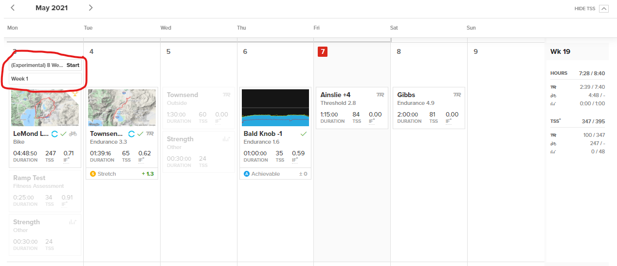

I’m going into week 2 but have just seen the new SSB plans and they look good! I’m tempted to stick to the polarised MV because it gives more room to weight train i.e. on the Monday and then cycle on wed/thurs and sat/sun
