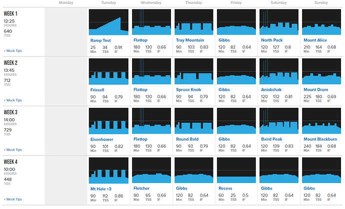

I don’t really see it that way. The majority of the TB is long and low endurance. The select Higher Intensity rides are sub-Threshold to Threshold at best (ignoring the few sprint anaerobic efforts).
TB2 HV
TB3 HV
To be true polarized via the 3-Zone model, those intense rides would need to be over Threshold and push up in the VO2 max range (105-120% of FTP).
The toughest looking workout Mt Hale +3, is at 105% of FTP which is barely on the line between typical Threshold and VO2 Max. It is plausible that this is close enough to count, but it is the exception within this plan, rather than the rule.
If anything, TB3 in particular swings towards the SST model with all the SS and sub-Threshold work. Either way, I wouldn’t call it “Polarized” in the same context as the rest of our discussion.

You are correct. When I made that statement, was mentally factoring in my planned outside ride substitutions. Thanks for clarifying and pointing that out!!
Cool. I think it could form a great start for POL, but needs some changes, as you noted.
