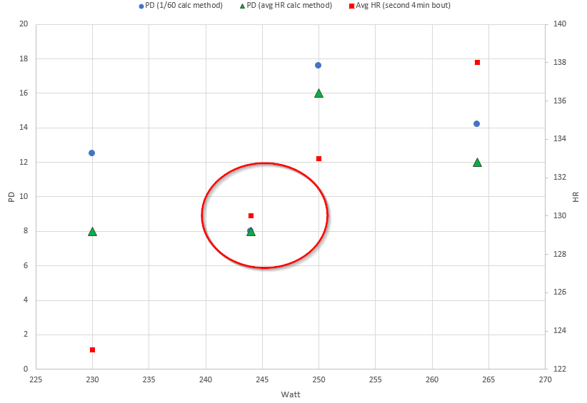

While I don’t see the usefulness of this, I was still intrigued how this 2x4min protocol compares. Did for 8min bouts around my LT1 markers (nose breathing test, heart rate at VT1/LT1 from several spiroergometries, ā€œexperienceā€):
grafik
It was not entirely clear to me how they calculated PD. I tried two different methods.
When I only consider the ā€œgreensā€, yes, there is a sharp increase in the region of my ā€œknownā€ first threshold. HOwever, the final data point at 265 W messes this all up.
Furthermore, I’m far away from PD =25 for LT1/VT1.
Nose breathing is less of a hassle …

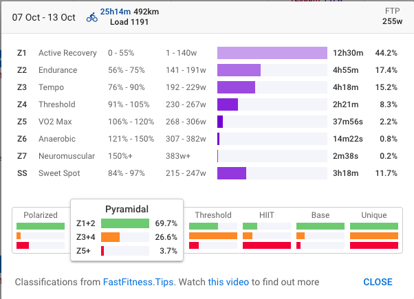

I am not sure whether you have seen this personalized polarized time-in-zone calculator? You enter your data and your training type and it works out your zone types: FFT Time In Zone Calculator [quick link: fft.tips/tiz] - Google Sheets. I think there might be another one in german, but I have lost the link.
Yes I’ve seen that. Intervals.icu use that to give a weekly report of TIZ like this.

My only niggle about the intervals.icu training distribution charts is that they work by power, whereas Seiler was working by HR.
My indoor session yesterday was all in HR zone 1, but 22% of the ride was power zone 3 – so it registers as ā€œpyramidal.ā€ Seiler would probably categorize it as polarized.
I must be blind. How do you access the weekly summaries in ICU?
I just went and figured that out as well - hadn’t noticed it before and wanted to see it.
On the activities page there is a link on the left of every week - when you click in that area it opens a pop-up that was screenshotted above
THANKS! I was in List view and don’t see the option there.
Switching to Calendar view and all is great :smiley:
I’ve messaged the guy at intervals.icu and suggested he did a zone distribution by heart rate as well. He said he’d add it to the list of things to do
