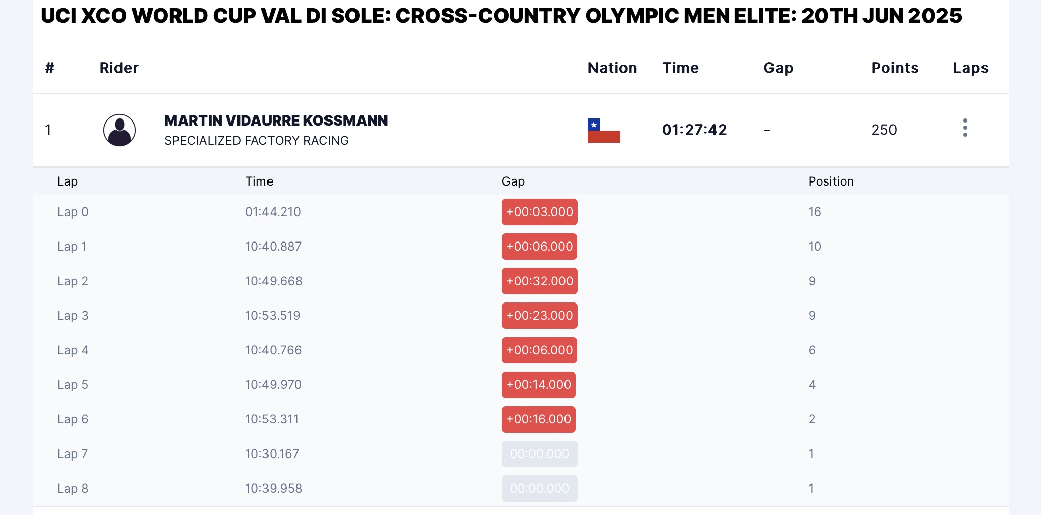

While they do go full gas at the start for positioning, they do fairly even pacing with a fast finish.

I would look at the results sheet and see what other people are doing. My experience is that usually the winners are holding the most consistent lap times, and after the top few, most everyone has increasing lap times and usually the lower down up the results sheet, the worse the consistency. One could conclude that better pacing would result in a better result. I think my takeaway is the opposite. The fastest XCO racers have the best durability. They have fast lap times and can do repeats of them. All this to say, be aware of how hard you go out, but you are probably doing just fine. Increased fitness will allow you to bring more consistency to your lap times.
