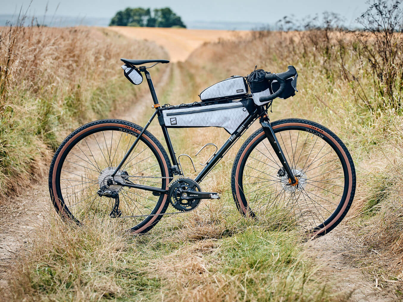

Fairlight Secan 3.0
Very few compromises unless you like to weigh your bike. I guess this is where it is maybe a little weak for racing CX. Proper mounting points and can even put a front rack (like the Nitto M18) on the latest carbon fork.
I have the more touring orientated Faran, commuted today on fast 35c tyres on carbon wheels and metal mud guards. Last weekend it was running a front rack, 2.1 inch mezcals and carrying camping kit for an off-road overnighter.
My partner has the Secan 3.0 and 2x wheelsets 700x50c and 35c. We both run GRX 1x with 10-51 cassettes which covers touring, commuting, loaded off road riding, etc. Her bike is smaller so hard to compare but the Secan does feel much livelier than the Faran.

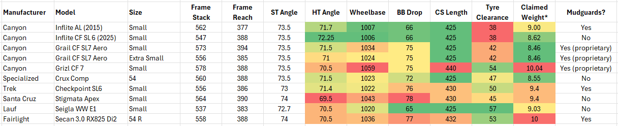

I thought this called for a comparison spreadsheet. So far I’m still not clear, but I think I can rule a couple of options out. I’ve left the Chumba out for now, I think it’s going to be much less hassle to get something in the UK.
The Lauf Seigla is catching my eye. Huge tyre clearance while retaining relatively short wheelbase, and with a BB drop close to my current CX bike. Weight can be reduced to ~8.5kg swapping a rigid fork for CX. Main downsides are no mounts, and direct to consumer/ high import fees / no cycle to work scheme.
I also like the look of the Grail, I just wish it took slightly larger tyres.

Great chart! Nice thing about the stigmata is that there is no toe overlap (that’s a thing I didn’t think about but really appreciate). The v4 has an official 50 mm clearance but people squeeze in 2.1 thunderbirds if wider tires are your thing. A bit heavy frame compared to some others like the crux. Great “west coast” gravel bike, as it can put on a geo correct suspension fork, but wouldn’t consider it a “do-it-all” bike like I would a crux.
