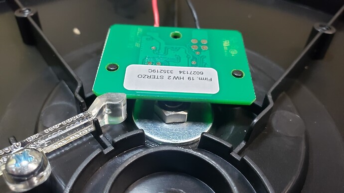

  • Just like I have done with my E-Flex Motion System. It has integrated Lean & “Steer” control for the main rocking action. I did a hack where I stripped down an Elite Sterzo, then reassembled it into a system with Technic Legos to be an active “lean to steer” control within Zwift.
  • The E-Flex front has a lean system with one fixed and one pivoting section. I have a connecting link from one to the other, that “turns” the Sterzo angle indicator that activates the “steering / lane control” in Zwift. Took a while to dial in the leverage ratio, but it works pretty well.
  • I still need to shoot a video someday, but it works reasonably similar to lane changes outside, including the basic “countersteer” input at the handle bar in conjunction with the lean.

Something like a Hall Effect sensor would be interesting to use for a ‘steering’ sensor on a motion platform. But Hall Effect sensors do introduce more complexity and another point of failure. Hmm… But so many devices use them.
A Hall sensor is actually at the root of the Sterzo Smart.
Hiding on the other side of the PCB is the magnetic screw assembly that rotates, with the sensor on the PCB to detect rotation. I just housed that in the larger LEGO gear.
I would be possible to keep this basic envelop if you did a gravity based lever, for a simple top mount.
The big problem with hall effect sensors is they are sensitive to heat, and tend to drift with age. That’s a huge problem for full-time gamers with some (computer) game controllers being notorious for having drifting and just flat out unreliable sensors. I got an email offering ‘drift-less’ sensors. I’m happy they thought of me, but I don’t ‘game’, other than Zwift. (I was a beta tester for Diablo III. That was fun)

I don’t think drift is a major issue here, but only have experience with my Sterzo before & after hacking. There is a calibration aspect in the Zwift app, so you can set it to “centered” which is easy with the spring-returned blocks. My setup is a bit more tricky since my action is lighter and I do it while on the bike for best “center” location. I also include a manual rotation option to fine tune if needed.
