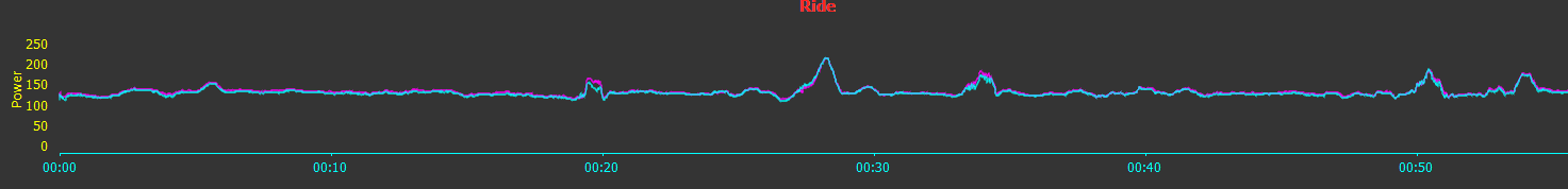

able to do some test today. here’s a comparism between Assioma and the trainer using golden cheetah. Consider my assioma is 3 yrs old…
I am very happy with the result.

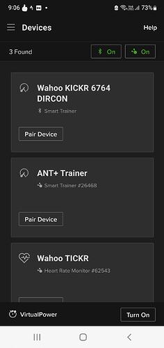

Anyone with a V6 having problems with direct connect working in Zwift? TR finds the Ethernet KICKR option near instantly, but tried it on Zwift for the first time today and it won’t show on any device I try on.
@tgarson On RGT once I started pedaling the DirCon option showed up immediately, Haven’t tried Zwift yet.
Yep, on 5.0.12. Trainer is awake and wifi status indicator light is solid white on the KICKR before attempting to connect.
I thought maybe it’s a quirk related to one device being on 2.4 vs the other being on 5 GHz but my same devices that find the DIRCON option in TR don’t find it in Zwift. I haven’t tried other apps like RGT yet but may try to see if it’s Zwift only.
