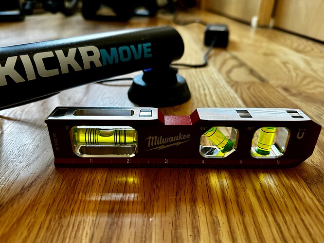

Have gotten a Kickr Move last week, upgrading from Kickr 4 with Axis feet.
I had the same issue with the unit being tilted out of the box. Easy to fix, but quite stupid that they didn’t make it work better out of the box.

Is it actually tilted or is your floor not perfectly flat?
I have the same issue, I had to unscrew the left foot almost all the way out to get the bike level:
It is not the floor. Wahoo provide a levelling guide for the base here:
https://support.wahoofitness.com/hc/en-us/articles/13398516227346-Leveling-your-KICKR-MOVE#:~:text=Start%20by%20leveling%20the%20KICKR,the%20rear%20of%20the%20base.
But if you set the base level the bike feels like it is leaning to the left. Even GPLama commented on it in his video.
