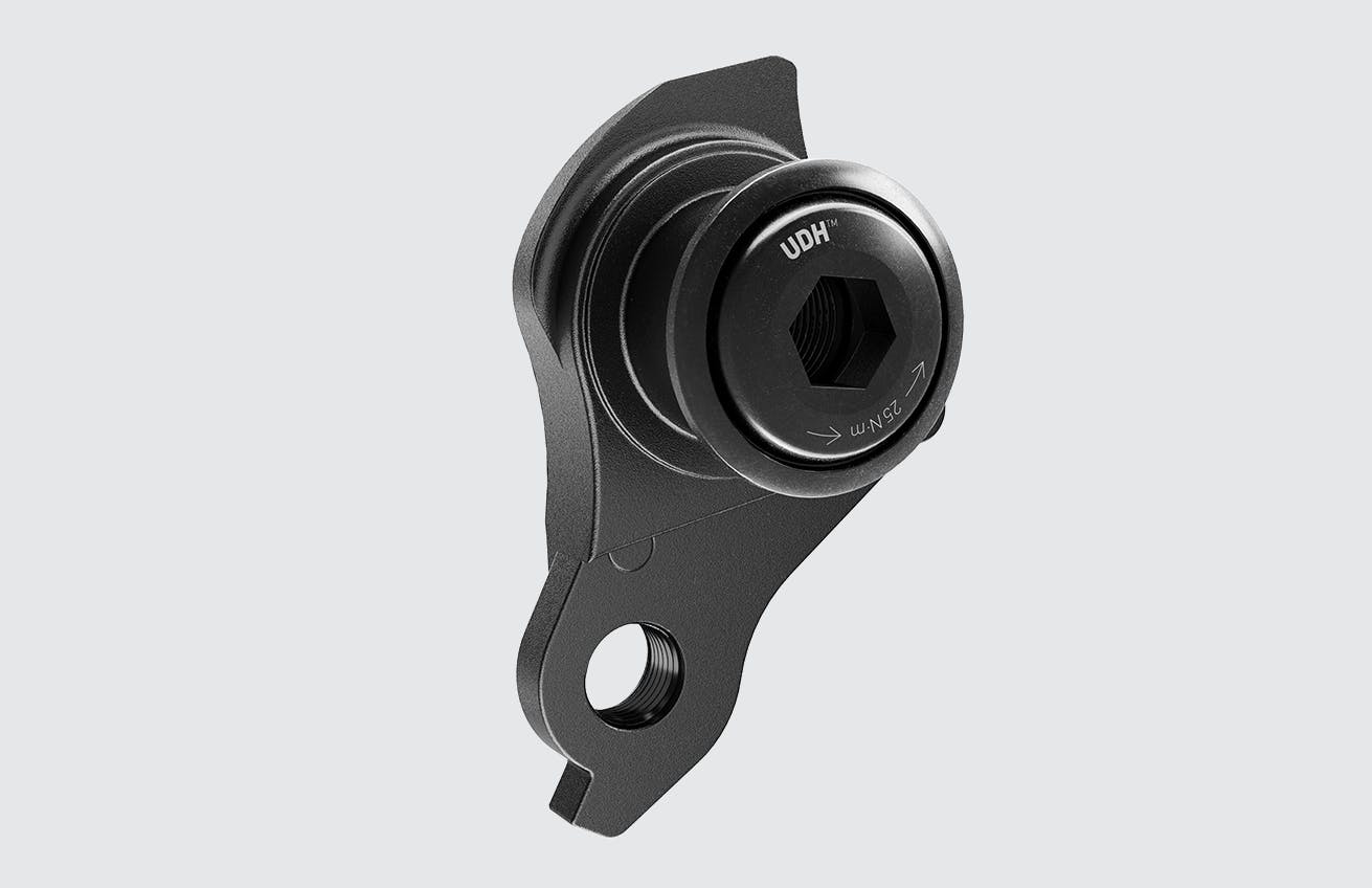

I did some digging and found this tool from SRAM, a UDH bike finder of sorts:
Looks like there are more compatible than I would have guessed.
It can be shifted with road AXS shifters, but the chains are different and chainrings “not cross compatible” according to sram. But I’m sure the mullet gravel drivetrain (big road 1x chainring, with XX/X1 chain, derailleur and cassette) will work and we’ll see it on some gravel race bikes this summer. Durability and shifting under full power are the big selling points of this new system, which is less important for gravel, so I don’t think it will be super popular in that world.

Correction, it appears older eagle chainrings would work fine with the new chain (according to Dave Rome at Escape). So I guess the issue is chainline. You’d need to find a way to move chainline 3mm outboard ideally, which according to sram means you need the new cranks. I’m sure there will be a solution (or maybe it will still work well with an inboard chainline).
Two of the first three UDH bikes I searched aren’t on there. Way to go SRAM

AFAIK UDH has become the defacto standard for mtb hangers, and has been for the contemporary ~cycle~ of bike releases.

He has the same concern as I do about the engineered failure point. Maybe because we’re both engineers with ME background. Weird.
The alignment is a good point too, maybe it won’t be an issue?

Sounds like UDH frame compatibility aside, there’s no guarantee that this new groupset will clear the bike frame. Cassette is further outboard.

Im certainly questioning the idea of ditching the hanger. Its nice knowing theres an engineered weak spot. On the other side, its one more point to flex which could be the reason for bad shifts? No current need to upgrade my gx axs so ill sit on the sidelines for a bit on this one
