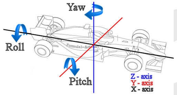

Hi @mcneese.chad , I was wondering if a rocker plate similar to the MP1 with the fore/aft, but rather side to side than a back and forth motion would give a more natural feel to the bike. It would essentially snake more kind of like being outside. Just wondering what your thoughts are. Thanks.
You are talking about Sway, lateral slide left and right as opposed to the typical Roll, pivot left and right?
If so, I’ve done some minor testing with what I feel is a unique concept to get the snaking, but I had to shelve it for a bit to deal with home remodeling. I don’t think a pure Sway will work. But something that includes it with Roll axis pivot is interesting to me.

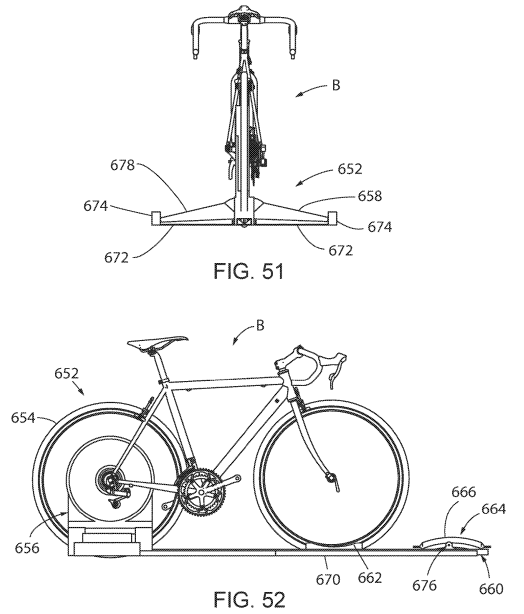

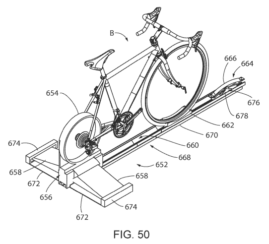

Looking through the Saris MP1 related patent, besides having dozens of motion designs for add-on platforms for separate bikes and trainers, we find some more interesting ideas:
Smart bike
Integrated trainer & motion
Will be interesting to see the impact of this patent on the progression of motion for inside cycling.
