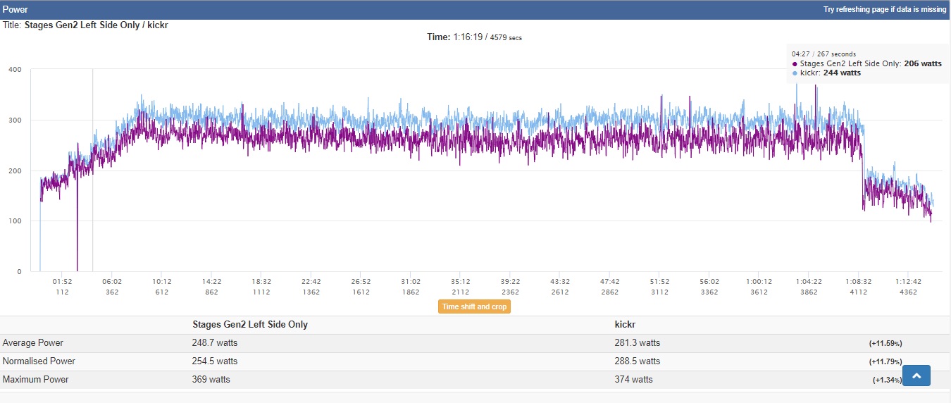

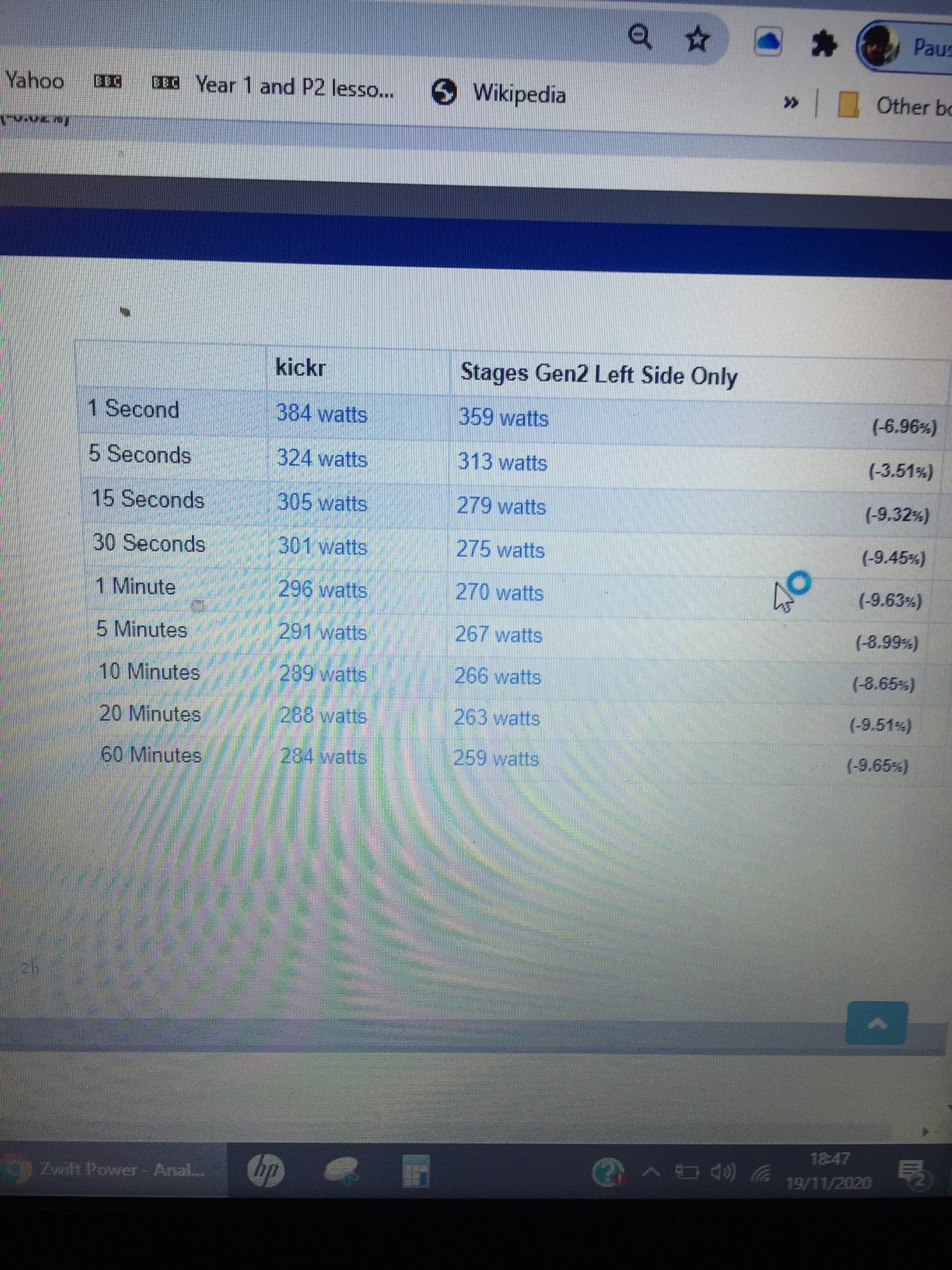

So I wanted to update this post with the power inaccuracies I’m finding which has resulted in Wahoo offering an exchange.
I’ve been using the Stages for 6 years so I feel I know what power feels like. I’ve aligned this with HR as well and it’s clear the KICKR is over reading. Great if you want to race on Zwift (I’m not) but not great if you want to use it for everyday training. Hoping the new unit works better.
I don’t see how you could intuitively feel a 2-12% difference.
If I’m doing a steady state effort, 60 minutes at tempo, then 299W would feel a lot different to 263W. My heart rate and RPE is firmly in the tempo range not the top end of SS as the KICKR Core is reflecting.
On these two devices, they would feel exactly the same, right? You are just assuming the Stages is correct and the Kickr is wrong. I’m just saying that there is no way to know going on feel. They could both be off by 6% and true power is halfway in the middle.

New KICKR Core arrived, setup, spin down etc.
Tonight’s session 60 minutes at 240-260w. (Tempo).
New Core 10% over Stages again.
I used Zwift and Kickr, Stages and BOLT.
Heart rate looks right for Stages. Going to try and get a 3rd source in the mix but there is something I’m not sure on. I can start my wahoo and Zwift at exactly the same time but after an hour (no stops just continual effort) the BOLT will end up about 10-15s ahead of the Zwift time. Could that be an issue?
Anyway. Deeply frustrating, was hoping the new one would align more with Stages. ![]()
