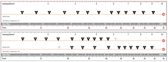

Below is:
- Top: Ekar with a 38t chainring and the 9-36
- Bottom: a 50/34 with a (Campy) 12-32 cassette (11 speed)
I agree. They didn’t make a big deal about it, but seems pretty clear from this that the smaller cassette is designed for road use.
The gearing range does seems great for a true mix of gravel and road flexibility. I was riding a lot of flatland gravel earlier this year, and a 40x11-36 Sram 1x worked very well. previously was used to 42 or 40x10-42, and that range works pretty well. Ekar with 42x10-44 on the gravel wheels is nearly identical to the Sram range everyone loves but also leaves the option of true road speed with a 9-36 cassette providing the top gear of 42x9–identical to a 46x10, which is a fast gear.
Exactly. And it is curious that they do not offer any chain rings smaller than 38. I think there are plenty of people who’d want a smaller gear than 38:9 = 4.22 as their top gear on a bona fide gravel bike. On the other hand, that cassette and that chain ring makes a whole lot of sense on a do-it-all bike where you swap out the wheels if necessary and either go on a road ride, off road or you put on wider tires with no or moderate tread.
