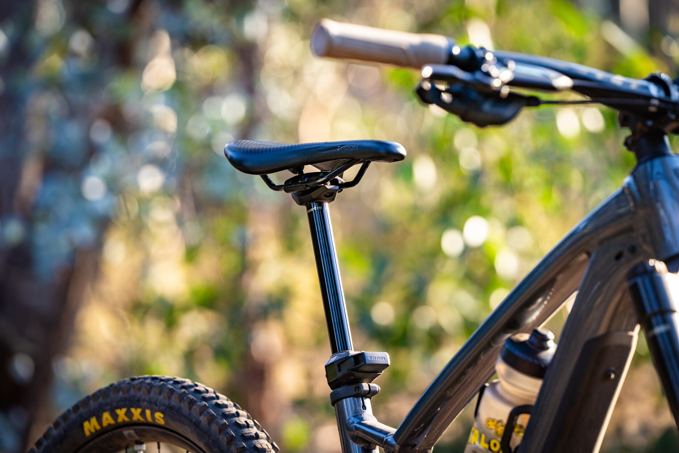

My wife got new shoes and insoles and a more rearward cleat position, so we needed to move from 150mm Reverb AXS dropper to a 125mm.
I bought an new/open-box 2025 Reverb AXS Dropper (125mm) via PinkBike., and my wife has reported that sometimes it does a “squishy thing” that lasts for more than a few minutes while she’s out on her longer solo rides. We’ve both occasionally experienced the known squish on our 2020 model Reverb AXS droppers and have had no issue fixing it with the “turn it upside down” method. On those older models, it was never intermittent. Once it started it just got worse until we fixed it, and then it would be good for months or years of riding again.
On the new dropper, the squish issue is intermittent. Is this a setting that is accidentally being toggled on and off? She can’t figure out when or why it’s happening but thinks it may be related to the ‘way’ she’s pushing the dropper activation button or ‘when’ she’s releasing it (as in, if legs are tired and she doesn’t stand all the way up before releasing the “raise dropper” press).
The big issue is: I can’t replicate it. Is intermittent squishiness of the 2025 Reverb AXS a known issue? … and does it have a fix, if so?
She starts Leadville MTB 100 in the silver corral in less than a week! I’d love for her not to have any mechanical surprises. I’m at a loss because I can’t replicate it and she can’t replicate it in front of me. If it’s anything like the squish issues we’ve had with our older models, it can be super fatiguing because you end up having to ride while supporting part of your weight. She’s using the dropper at Leadville because since learning how to use it, she’s started taking descent QOMs and feels far more comfy descending with it down. (as I think anyone would, who understands how to corner well!)

I don’t have one but I have the XPLR dropper on my gravel bike and I’ve read the new AXS droppers work similarly. If it isn’t fully up or fully down, it’s supposed to provide a bit of movement/ cushion. So drop the saddle like 1cm and test to see if that’s what she experiencing. If that’s it , then the post is working as intended.
When my first gen had occasional squish and I couldn’t fix it with the vent valve procedure, only a rebuild helped as it should not intermittently squish at all. I’m afraid perhaps someone sent you a defective unit
Is it the ‘ActiveRide’ described here?
Interesting, having ridden with a slightly squishy post I found it extremely annoying and would not want to have this as a feature.
I thought I remembered hearing this but can’t get it to do that. I’ve read the manual and see ActiveRide tuning mentioned. I’ll read more. She has mentioned she thinks it’s happening more when she’s fatigued and doesn’t stand all the way up.
Completely agree for XC racing. I can see a use case for DH/Enduro. My version of all-mountain riding is usually far too many miles for my legs to tolerate it. :slight_smile: Surely it’s disableable…
Does anyone know if ActiveRide can be completely disabled?
