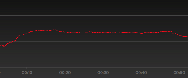

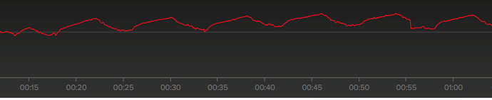

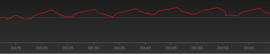

With some trepidation I tried Nunburnholme that @Captain_Doughnutman mentioned earlier (at my far lower FTP of 170) as my hard workout of this week, and managed to complete it (if pee break before 6th interval doesn’t nullify). Resistance rather than Erg for more control over physiological intensity (i.e. HR). I appreciate the return to Resistance more and more, not just because of some device hassles with Erg, but because of at least the illusion of more control — e.g. coming in a little above target rather than always slightly below no matter what I do.
Resistance also allowed me to start the intervals hard (for me) – to ramp up HR faster. Ha! I do get pretty conservative after the very first interval because the hard start really does affect the rest of the interval — the whole point. Trying to “feel” ideal pacing I find really tricky because of the games my mind plays when the going gets tough — “I’ll blow up for sure!” — so I do have to refer to the numbers as a reality check (crutch?) — “You’ve done this before, so quit dramatizing.” I found it pretty interesting trying to juggle gears and cadence to keep the interval as hard as possible without bailing. In the final interval I was actually able to use HR as my pacing metric. Vicarious geezer thrills for racing he never did and never will.
Still leaves me the question I started with. Namely, if I want the most bang for the least time in Seiler’s Z3, should I do TR intervals (even custom intervals) that give my heart a workout in the familiar sawtooth?
Or, should I slum in Zwiftland once a week and do a short crit, where the 10 min crazy ass start ramps up my HR immediately and then keeps it there as my work intensity falls (a lot) to a just sustainable level, but HR stays pretty high? Like this:
HR Zwift Crit
The latter gives me way more time in the really hard zone. But because of the race distraction — trying to keep up, the scenery, etc — it goes by very quickly and a few minutes after it’s over doesn’t feel any harder than the structured intervals, although it must have been. I don’t want to be damaging myself by the Zwift frenzy, but it seems in ways an easy solution to the “really hard” day. My goal isn’t to be the fastest I conceivably can, but to get slower as slowly and healthily as I can with some exhilarating moments thrown in. Let me know if this actually belongs in one of the geezer threads.
