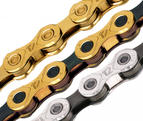

I’ve got a mixed 12 speed bike, some KMC chains are advertised as working on both SRAM / Shimano.

EDIT: Looks like KMC doesnt work well with “flattop” chainrings after all, although they say they it does…
