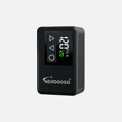

I’m using this one - £52, with a 5 year warranty. Looks to be the same as the Cycling Cadence one. Inflated my tyre twice and had about half battery left.
Tiny, about 128g. Works really well.
Tried two cheaper models from Aliexpress, Rockbros 150 psi and Cyclami thing, both useless.
