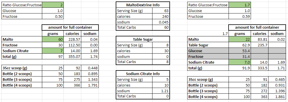

I’m curious, when I went closer to 1:1 gl:fr using maltodextrin:fructose I could hardly take in the drink mix it was so sweet. I’ve done some more at 2:1 and found it much more palatable. I’m just not sure how to get to 1:1 with the sweetness not getting cranked up so high.

Thanks for the feedback guys. I do use sodium citrate. I found 7g is a good point per serving. I tried 15 once and got cleared out! I haven’t also included table salt in a serving too, so I’ll have to give that a shot.
I did try table sugar instead of fructose and was able to get to a 1.7:1 ratio doing it that way. Was going to try 1.5 the next go around with the table sugar to see how that tastes.
Experimenting like this definitely makes me appreciate how good Infinit has gotten at developing their product as it’s bulletproof for me, but I like to tinker so wanted to try this too.

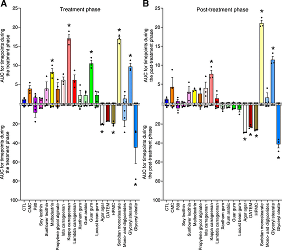

Stay away from Maltodextrin if you can. At least be aware of what it might do to your gut and health
They do find that malto causes changes in intestinal bacteria in a lab environment. But then go on to note that it’s possible that in real life, it may not even reach those areas of your intestines due to quick digestion
“Such results are consistent with accumulating evidences demonstrating the detrimental impact of maltodextrin on the intestinal environment [9, 10, 30]. However, it should be pointed out that this polysaccharide is thought to be very quickly digested to glucose and absorbed in the small intestine and thus may never have the direct impacts with colon bacteria that we sought to model. Thus, discernment of whether the impacts observed really relate to maltodextrin’s impacts in vivo requires further investigation.”
Still potentially interesting
You are right and of course everyone is free to conclude out of that what he wants. My own conclusion is to stay away from it until mentioned in vivo investigation exists. If I’d get paid to perform, that might look differently.
