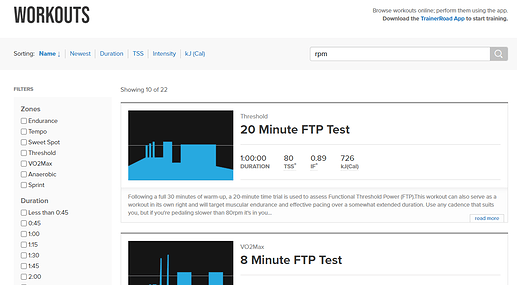

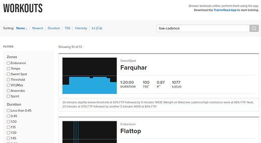

There is no list or program, but you can search in workouts to find some specific mentions of “low cadence”
Or use “rpm”
