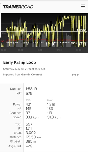

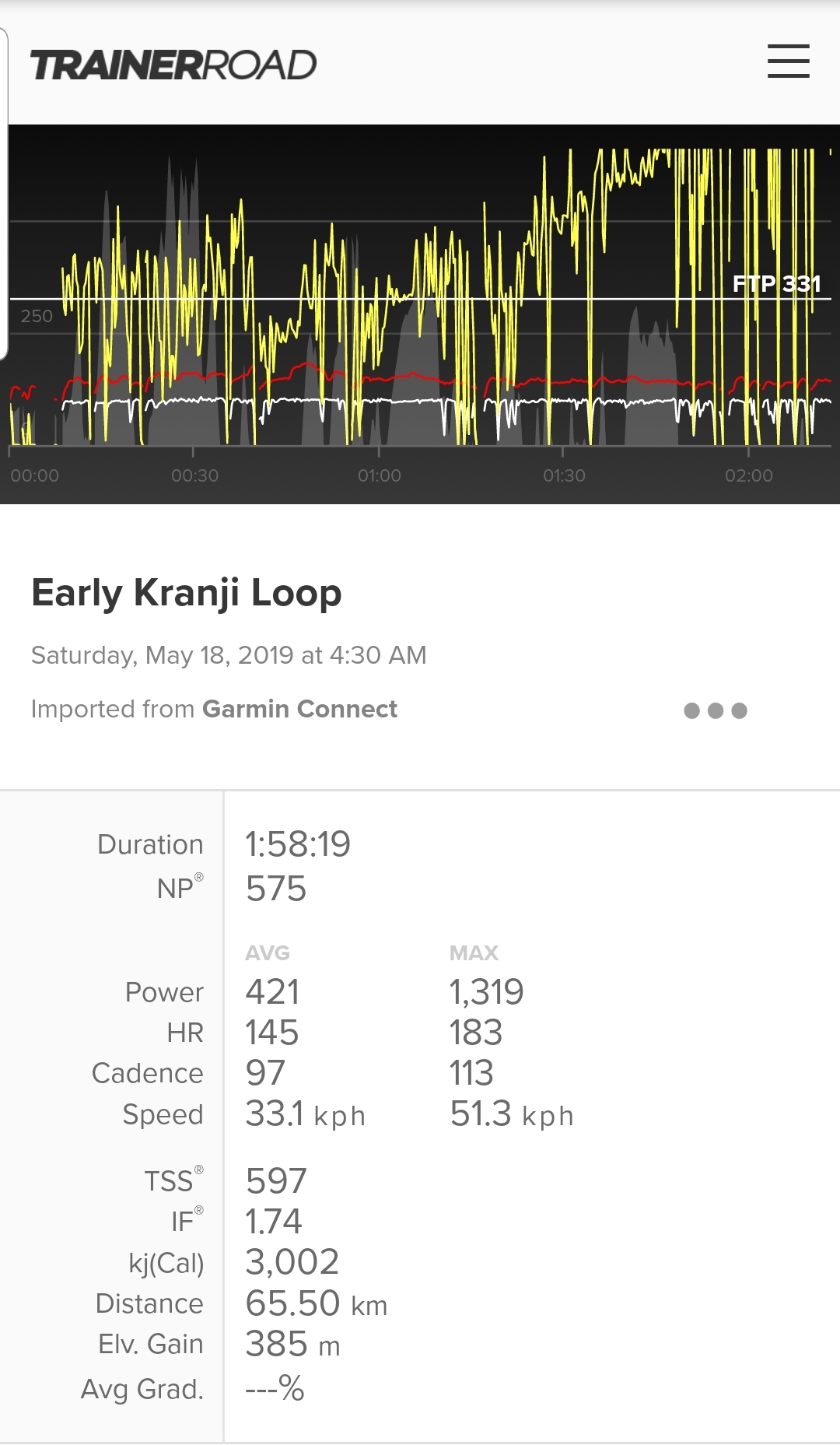

Recently my Gen 2 freaked out.
I went outside and did the zero offset like I usually do before every ride. I did notice that the offset value was a bit off compared to normal, but thought nothing of it.
Started the ride and I noted some further odd behavior - some dropouts and higher than usual wattage. I carried on riding and zeroed again a couple of times mid-ride. The offset values got more freaky and my power just kept getting higher. I finished a 2h ride with average power of 421w and TSS of 597
The ride was duly omitted from my stats.
My stages is 3y old and I just assumed it had died. However, during my investigation, I opened the battery compartment and it was damp, with a little corrosion on the battery. Couldn’t tell if the damp was water or battery leakage. My previous ride had some rain and maybe the o ring allowed some water to get in, causing the problem? Maybe it was a bad battery? Who knows.
I dumped the bad battery, dried and cleaned out the battery compartment. Then let the pm dry out completely. Installed a new o-ring and new battery and everything is back to normal. Happy days.
