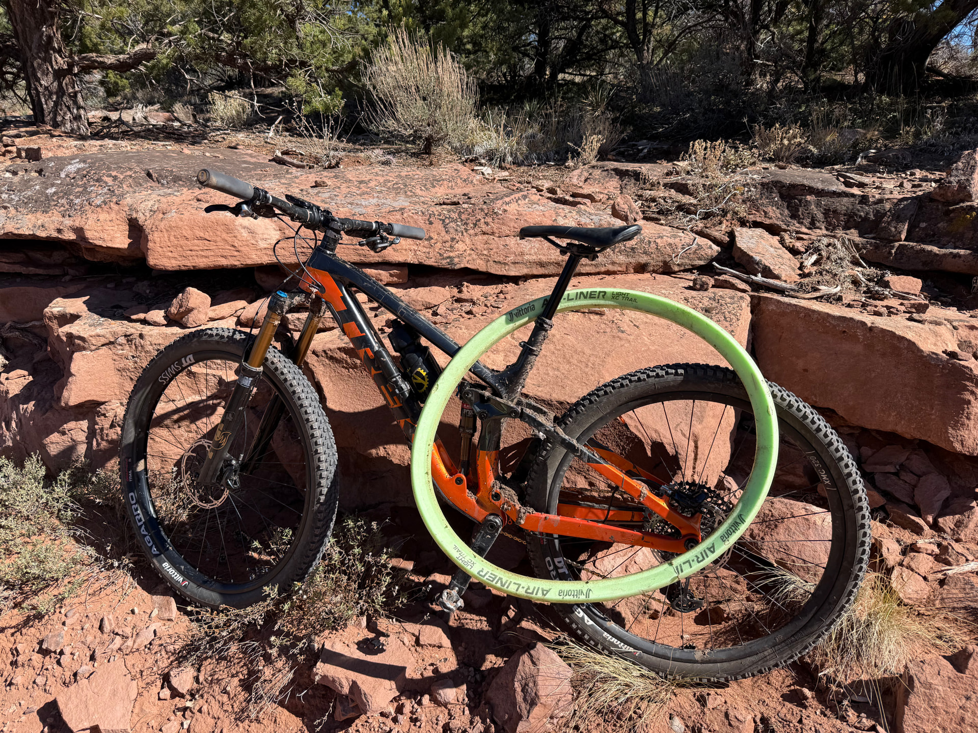

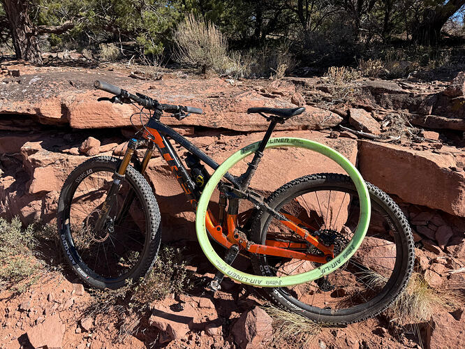

I’ve run inserts 100% of the time for all training and riding since 2023. Vittoria Airliner and Tubolight Evo SL. I’m going to continue to do it because I think the benefits outweigh the cons.
I was on a ride this year that by all intents and purposes had no need for them, and felt a freak rock strike that I’m convinced would have caused me problems, but with the insert, no issue. (Pretty sharp / hard impact from a rock that got kicked out)
The downsides: A little extra weight, a little extra sealant, and it’s more of a rodeo if you have to put in a tube. But let’s be honest, that’s already a rodeo. Will not prevent or help with sidewall tears other than the benefit you get from running lower pressure. I’m 80KG and ran 14F/16R at Leadville with the Dubnital this year so that is nice.
