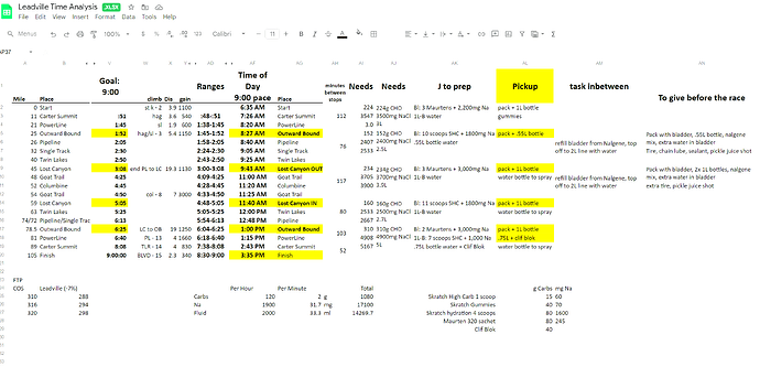

Green corral as well. Targeting sub 9 and these are the splits I shoot for. I know a steadier pacing strategy would allow you to make the turn at columbine at 4:45 and still hit sub 9, but I like to have some buffer in case issues arise in the 2nd half of the race. Flat, gut issues, heat, sometimes the headwinds pick up, etc. And I don’t want to be right at 9 hour pace late in the race and get tempted to push hard on the downhills when fatigued. I’ve made the turn at columbine in under 4:35 every year I’ve gone sub 9 and always had a 10+ minute cushion at the end. So, I guess the first half of my pacing plan is really an ~8:50 pacing plan.
I think my splits are similar for a 9 hour pace starting from blue

While I spent hours making the pace chart, I’ll ultimately pace by power and RPE and know when to pull the plug based on prior experience.
