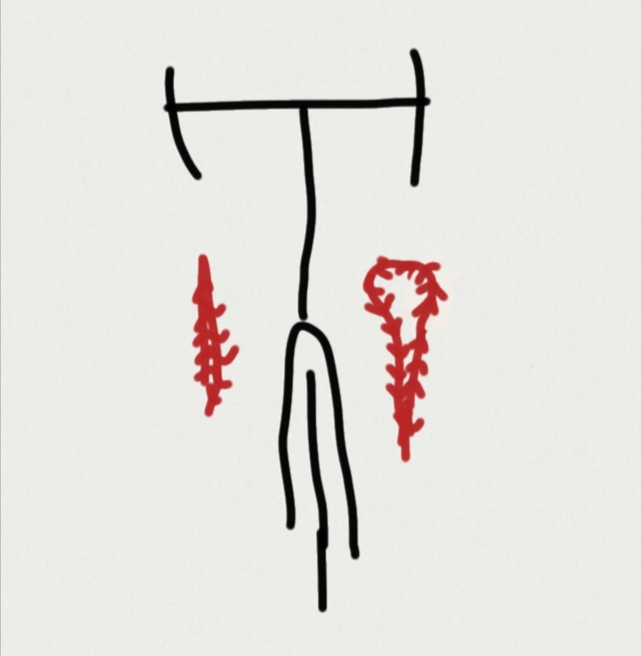

Hey there,
I noticed that the trajectory of my left knee is a bit…unstraight.
( see photorealistic drawing below )
This is a front view.
My right knee is not perfectly straight, but nothing significant.
On the other hand, my left knee starts to go outside on the up stroke, and inside in the down stroke.
Though it gets messier the more watts I produce.
If I go harder, the pattern at that top gets more chaotic, like my knee doesn’t know where to go before the down stroke.
Any ideas on what kind of problem would cause this?
Cleat position? Saddle position? Hips imbalance?
I plan to go do a bike fit if it becomes a problem.
PS : I’ve been cycling for 4 years with no problem, 2 years and a half with my current bike, but got left knee problems the last two months ( patella tendon inflamation, but it’s healed and I don’t feel pain anymore )
Maybe the pain and this problem are linked
  • All of the above, and add in stuff like prior injuries, general range of motion issues, physical abnormalities or asymmetries, and the list goes on.
  • That is all you can really do. It’s impossible to give any meaningful guidance with so little info, especially not seeing you actively on the bike.
Generally speaking, people will have a potential of having these types of “imperfections” but may well be getting along fine in spite of them. As a fitter I might see something like that and the main question to start with is “Is this really a problem?”.
In the spirit of the Do no harm ethos, I tend to only tackle stuff like this if I feel it is linked to an actual pain, injury, or comfort issue presented by the rider. That in mind, unless you know you are having issues, I sure wouldn’t suggest chasing it as an issue on your own. If you end up with a fit session for any reason, certainly mention and discuss it with them. Then you two can decide how to address it, if you do at all.

Is it a consistent “wobble” or does it only present intermittently?
I have an intermittent “wobble” on my right knee, but 90% of the time it’s perfect. Left is solid always. I suspect it happens when my sit bones are shifted slightly off-center or forward on the saddle. I also had a severe lower leg injury on my right leg that still limits ankle mobility, and it’s all connected, so that could be it too… but honestly I don’t pay that much attention to it.
I have no issue with it, no pain, so I don’t worry about it at all. I’d recommend the same for you if it’s intermittent and/or not causing you any other issue.
When I did a bike fit, I also had a little left/right movement in one knee. What solved it for me were insoles. Also, I had an immediate feeling that my feet were much more stable while pedaling.
Some people have flat feet, so most shoes come with little support under the arc of the foot so that it is not totally uncomfortable for some. But if your feet aren’t flat, you can benefit from using insoles that provide a bit more support and a stable platform as you press down on the pedals.
It’s been a while I’ve been wanting to get a better cleat position, but it’s a complicated subject and hard to get right i feel like. So i’ve been a bit lazy about it.
I’ll have to mention it if I get a bike fit.
It’s a consistent wobble, it’s always there but gets worse as I put more power, especially on steep climbs where I stay seated.
Sometimes I feel like I have more weight on one side, and I have a very poor ankle mobility ( I’m working on it though ) so it may be worth it to check if those are possible causes.
