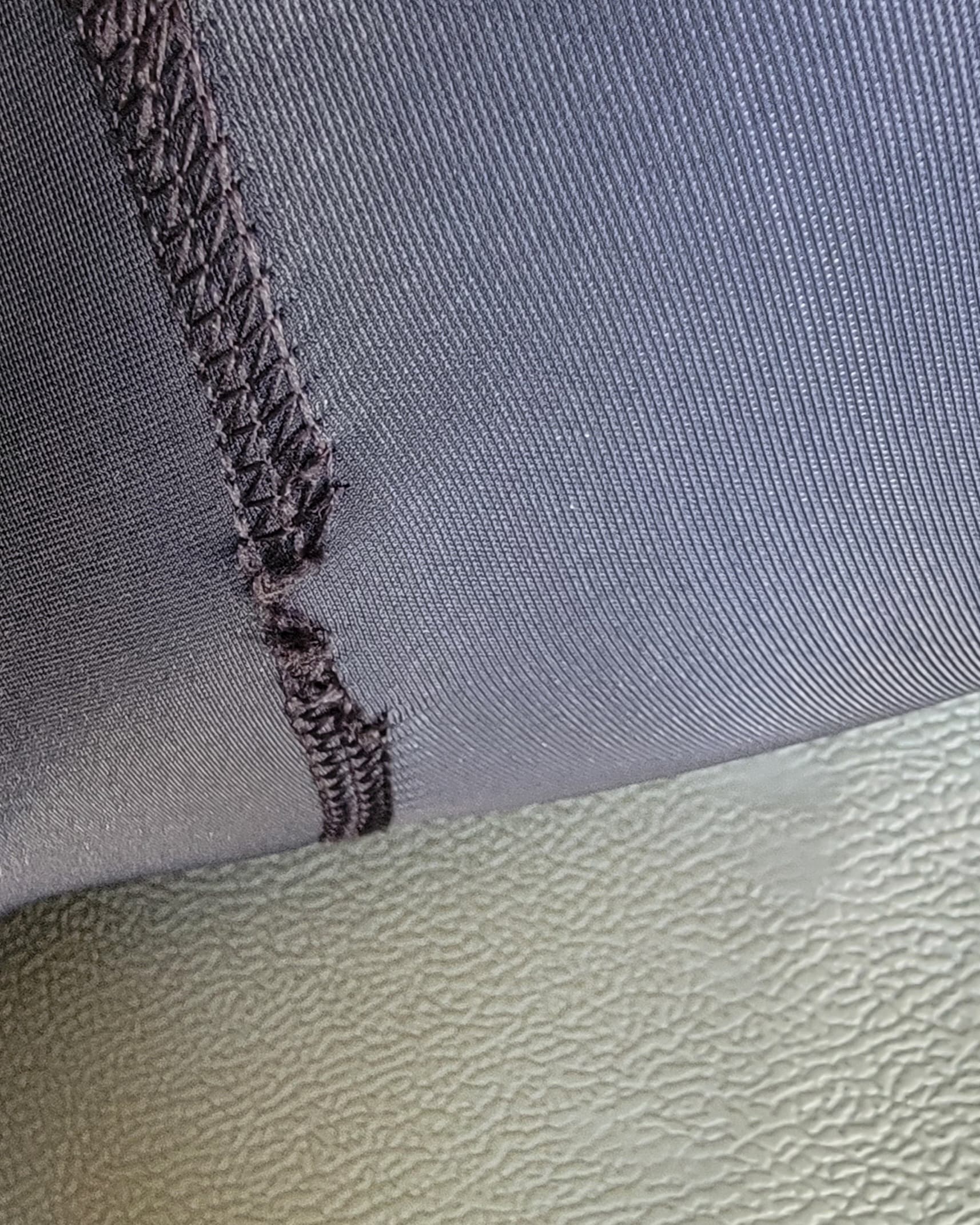

I keep shredding the stitching on my bibs on the inner thighs and don’t know what to do. These are Rapha Core bibs after 70 miles :melting_face: I’m a tall guy with a bit of weight to lose but nothing too crazy. I do have somewhat thicker thighs I guess from riding and carry a bit of weigh there I guess.
I’ve had 2 bike fits that gave completely different saddle positions and I ended up somewhere in the middle. I’m very comfortable on my Bontrager Aeolus saddle and with my current fit. Recently did a 128 mile ride and was comfy so I’m hesitant to change anything fit related.
Could this be a Rapha issue? I’m hesitant to buy more premium bibs if I just ruin them. Could I cover this stitching with some kind of seam tape or something? Any tips are appreciated!
I’d bet money you’re rubbing on something. I ruined several pairs of Assos shorts before I noticed I was rubbing the saddle through. The Assos rep did me a massive solid and replaced them when I first noticed the problem, but after rubbing through the new ones, I realized it was the saddle and not the shorts. Looking through the forums, it seems to be short nosed saddles, probably from rubbing on the wings.
I used to wear out shorts one one side due to a leg length discrepancy (but never that fast). Id contact Rapha.
Back in the day I rubbed a hole in a pair of shorts in the strap that held a saddle bag so maybe that’s possible?
Where is this seam on your bibs? I can’t tell from the close-up shot.
Inner left thigh…looks like it must be rubbing on the saddle or something :melting_face:
What saddle were you using? Did you end up swapping it?
Which side wore out on the shorts…the side with the shorter leg or the longer leg?
One of my 2 fitters suggested my right leg could use ~3mm shims, and I’m losing stitching on the left :thinking:
IIRC it was the right side, my marginally shorter leg. It was 11 years ago I had a fit which found the 2.5mm difference and I definitely wore out shorts and saddles prematurely.
If your right leg could use some shims, rubbing on the left would make sense, as you’re likely shifting slightly to the right (to reach the right foot lower at the bottom of the pedal stroke), this bringing the seam on the left leg into contact with something (saddle, rail, post clamp, etc).
