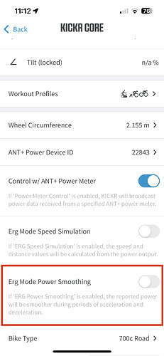

I use the in app workout player paired with a kickr core. Is there some way to apply power smoothing? My numbers seem to jump around a lot more compared to TR
Yea the app has its default set to 1 second power, you have to change it in the settings every ride.
The choices are 1s, 3s or 10s.
I really like using 10s for longer intervals or endurance and 3s for shorter intervals < 2minutes.
The wahoo app has a power smoothing setting to turn it on and off as well. Not sure how this will work within the confines of the JOIN workout player, but it does work in other apps (TR, Zwift, etc)…
Do you have this setting enabled in the app?
