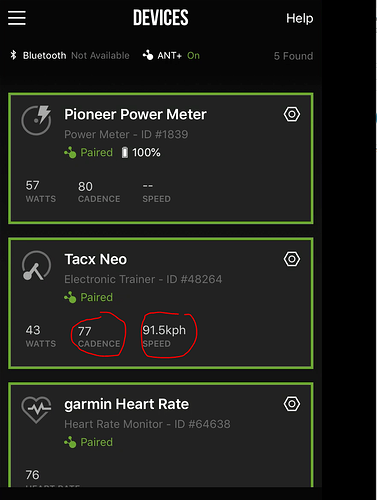

When I pair Tacx Neo via Bluetooth as Electronic trainer, speed shows OK. No issues. TR software transfers the data OK.
When I pair Tacx Neo via ANT+ as Electronic Trainer, speed shows incorrect. Speed reading problem. TR software transfers average speed way above average
When I use Speed and Cadence sensor on Tacx Neo and leave Tacx Neo as electronic trainer via ANT+, TR software reads speed from Speed and Cadence sensor but Tacx still shows high speed. TR software transfer data OK.
Tacx Neo and TR App are both at latest firmware and version.
For clarity, I am attaching my screen shots. Any ideas?
